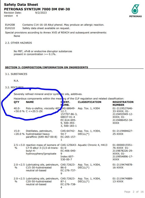

What car ? Because it depends on what ACEA standards your car demand. I don't really look at API standards much.
My opinion is, if you don't have a small turbocharged direct injection petrol engine, then API SP oil don't really benefit you much. The main reason API SP exist is to prevent LSPI , low speed pre-ignition. So what oil manufacturers do to get API SP certifification is reduce the amount of calcium which the function is to neutralize acids that are produced during the combustion process, preventing corrosion of engine parts. That is because calcium has been shown to promote LSPI .
PAO oil got plenty out there, not cheap. Got plenty of different concentrations also.
The ones I know:
~30% PAO base oil = Syntium 7000
Similar to the Motul 8100 Power above = LiquiMoly Synthoil Energy 0W40 , Synthoil High Tech 5W40 ( If you want PAO based LiquiMoly engine oil, only buy Synthoil , no need look at other variants)
Ravenol VSI also PAO based.

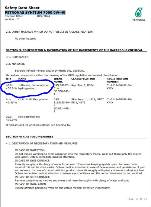

QUOTE(k!nex @ Jun 9 2025, 06:15 PM)
The ones I know:
Syntium 7000 is not pao based on petronas website
k!nex
post Jun 9 2025, 07:07 PM
Restless stars
3,391 posts
Joined: Mar 2007
QUOTE(ry8128 @ Jun 9 2025, 06:28 PM)
Maybe for other viscosity like 0w-20 but the 0w-30 has some PAO.
This is a safety data sheet to comply with EU regulations. Usually this is where the hints of PAO quantity.
Even 0W-40.also is PAO based.
This post has been edited by k!nex: Jun 9 2025, 07:28 PM
Ah, okok. Cos I was looking at 0-20. Later I check again. Thanks man.
TSry8128
post Jun 9 2025, 09:22 PM
♣Just a noob♣
3,642 posts
Joined: Jul 2014
QUOTE(k!nex @ Jun 9 2025, 07:07 PM)
Where you see 0-30? I see their website don't have such viscosity.
https://my.pli-petronas.com/en-my/products/petronas-syntium
