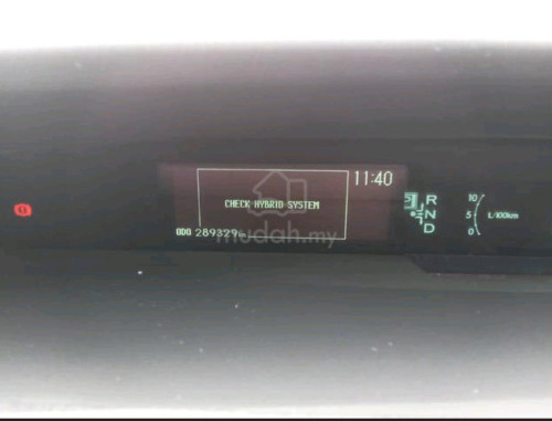

 Toyota Hybrid need tow truck also?
TSkembayang
post Jun 8 2025, 03:11 PM, updated 7 months ago
1,441 posts
Joined: Oct 2017
Common problem ka?
How much to fix?

does not look like cross hybrid...
anyway my hybrid got hybrid system malfunction before... then turn off and turn on, no more issue

2010-2012 Prius / Prius C

Dude... 13 years car is more than 9 years loan. So something failed is not un expected.

almost 290000km somemore

battery issue, 3k-5k can fix

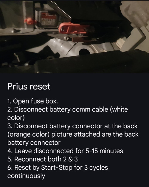

Got info from Prius C owner club member:
"Need to reset Hybrid battery. Two location cable yellow color to be removed. One: at engin side (front bonet) and two: at back (around spare tyre area).
Reinstate back, the cable, and try to start engine again.
nabs2205
post Jun 8 2025, 04:05 PM
14 posts
Joined: Sep 2012
nabs2205
post Jun 8 2025, 04:08 PM
14 posts
Joined: Sep 2012
Never done this myself. But this what I got back in 2021 when I had the same issue.
Managed to start the wmengine normally and drove it to SC.
No issue until now, thank god.
Prius C owner since 2012

Either hybrid battery or inverter gone case. Either one is equally expensive.

Replaced the aux battery IF not mistaken.
My hybrid battery was exchanged (during warranty) after 6 years of usage. At the time I had to pay RM350 for battery replacment service charge while the hybrid battery is warranty replacement.
