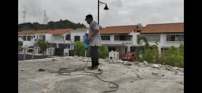

Day 1, remove all existing ACP awning before extension. Attached Image Attached Image Attached Image Attached Image Attached Image Attached Image Attached Image Attached Image
And all cleared.

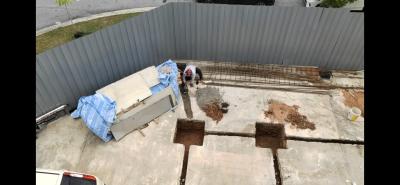

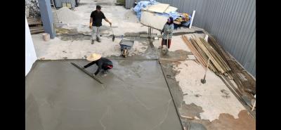

Next we hack and dig for footing and ground beam, construct footing and ground beam using bs Y12 and concrete, level concrete floor.
This post has been edited by DeanWong118: Jun 5 2025, 02:19 PM

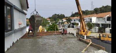

British standard Y12, BRC A10 on top of the plywood, new concrete floor for 1st floor.

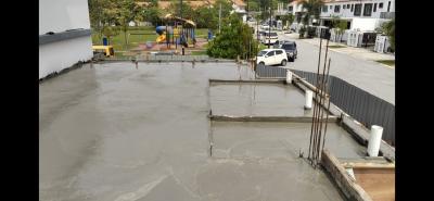

Column, roof beam and concrete roof for 1st floor.

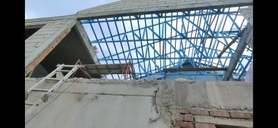

C channel roof truss and batten installed.

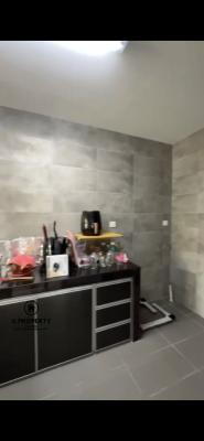

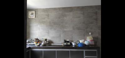

Existing wet kitchen

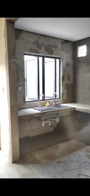

Construct new concrete bench after completed cement plastering the exterior wall.

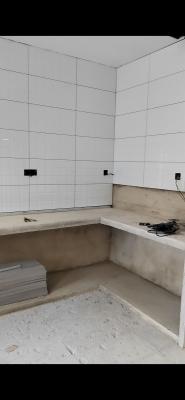

New wet kitchen tiles

The white tiles look a bit dated

Hi, it's not the matter of the tiles, it's the matter of the tiles is suitable for the house concept or not.

Example terracotta tiles is suitable for rustic, Mediterranean house.

Installing top hung window after completed cement plastering all walls.
