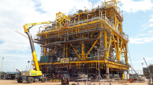

What course/certificate needed to proceed doing this?
Can he/she be sue if just do the cable testing & termination without proper certificate & courses?
