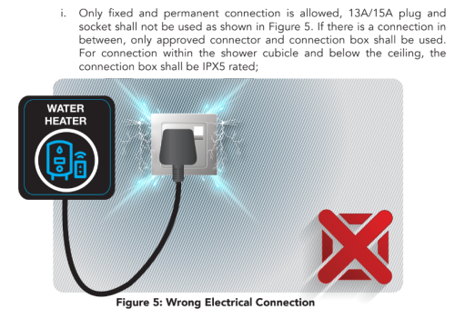

Make sure not to use plug and socket connection for water heater, as this is against Suruhanjaya Tenaga guideline.
You can either:

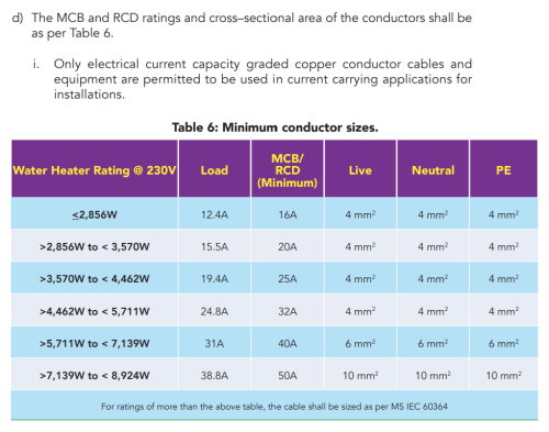

1. connect the correct size electrical cable (4mm for water heaters with power rating below 5.711kW) from the bathroom switch outside your bathroom directly to the water heater, or
2. if the developer unit had mistakenly pre-installed with a 3-pin socket in the bathroom (which is definitely not compliant according to Suruhanjaya Tenaga), and u find it tedious to cover the junction box back with cement and paint, then alternatively u can replace it with a Water Heater Connector (eg. shown below, Shopee / Lazada). It is not a necessary product for water heater connection, just a quick fix for mistakes made by developers that have pre-installed 3-pin socket in the bathroom.
Also check to make sure the MCB, switch, and electrical cable for the water heater power connection are up to spec (refer to Suruhanjaya Tenaga guideline below). Power connection for water heater has to be a dedicated one, cannot be shared with any other appliances.

QUOTE(epep @ Apr 15 2025, 11:48 AM)
Thanks for the advice, Selene. Good to know! Is this a new guideline? Or is it just that, since it's a guideline and not a law, some electricians don’t follow it? My old water heater has a plug and is connected to a wall socket, but now I’m a bit concerned the electrician didn’t mention this during his inspection.
This Suruhanjaya Tenaga guideline has been there for many years, and have to be followed by all SIRIM certified water heaters, which means that their instruction manuals will state the same requirements as the Suruhanjaya Tenaga guideline.
Here is Suruhanjaya Tenaga's contact details if u need further clarification.
What's the possible downside for not following the Suruhanjaya Tenaga guideline and the water heater's instruction manual?
1. Safety issue | The risk of electrocution and fire hazard is higher (especially true if your electrical components are wayyy under-spec'ed).
2. Liability / insurance / warranty claims issue | Since you are not following the instruction manual and Suruhanjaya Tenaga guideline, this provides a justification for the insurance companies to void your insurance claims / for the supplier to void your warranty claims, if your water heater is damaged or even (touch wood) caused harm to you (eg. fire / electrocution).

1.He said it's okay to use a socket for the water heater.
2.He also said that he can install an ELCB/RCCB for the water heater circuit (and that it would be more expensive than the main house ELCB/RCCB), it's not necessary.
So I googled around and I found a document called "Guideline for the Design, Installation, Inspection, Testing, Operation and Maintenance of Water Heater Systems" on Suruhanjaya Tenaga's website. (Document link)
On page 18, it clearly states that sockets are not allowed for water heaters (this matches the diagram in Selene's post). And on page 16, there's a diagram that mentions "installation of RCD with leakage current sensitivity of 10mA in a wet area is a statutory requirement." I’m assuming an RCD refers to an ELCB/RCCB, right?
For point #1, I’m planning to buy a waterproof connector on Shopee and ask the electrician to use that instead of a regular socket.

There are rules and regulations that has to be followed for electrical installations. Some are technical based (like the size of a wire for a given load) some are safety based (like having a 10 mA RCCB for wet areas) and some are arbitrary (like all water heaters should have a minimum wiring of 4 mm²)
Let's expand a bit on the 4 mm² requirement for water heaters; an installer might try to convince you that your WH is only 3000 W so 2.5 mm² wire can be used as the current flowing is (3000W/230V = 13A) under the wire limit of 20 A. So this is an arbitrary requirement from ST. If you know what you are doing and accept the risks and consequences, then by all means save some money and use 2.5 mm² wiring. My professional opinion would be to strongly recommend you don't cut corners though.
(Aside for a complete look at the issue : The requirement for 4 mm² was introduced in 2000 (I think?) so there probably are millions of WH installations using 2.5 mm² wiring with no issues. They also do not have that 10 mA RCCB protection, again with no issues. But both of these are statutory requirements now)
In conclusion, follow everything that is stated as a requirement in the ST document that you downloaded, and do not hire any so called "electrician" who tells you otherwise.
