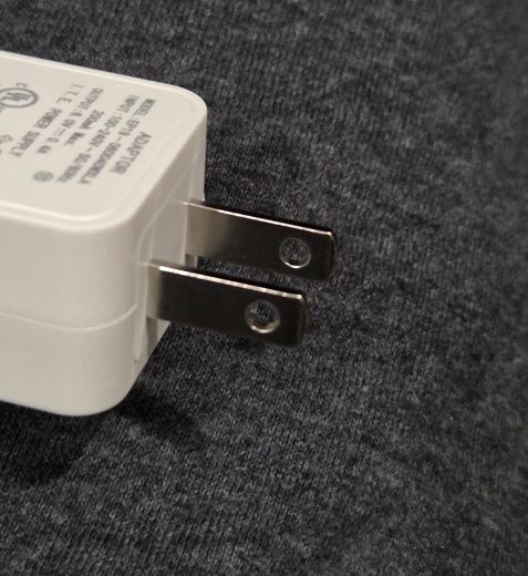

I bought this device from Amazon USA, but the plug doesn't fit. I've not seen it before.
Please assist how to get it to work and if it safe to be used?

Can use a universal travel adapter. Alternatively if u know an electrician ask him to cut and change to Malaysia 3 pin plug

QUOTE(FishGuts @ Mar 23 2025, 11:03 PM)
Cannot cut the wire. The adaptor itself is already a transformer...adaptor is the best

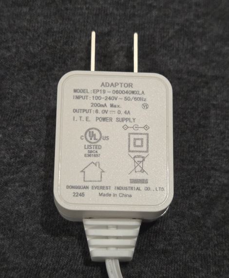

What device is this?

Motorola Audio Monitor. But the plug is suspicious, some China company. It is an original device bought from the official store.

literality 90% of the plug converter can convert this

Luckily its universal voltage (100~240v), so can use here.
If its 100-120v cannot use here as our voltage is 220~240.
Just get socket converter, it will do.
Mr diy or electric harware can assist. Just bring along, they can help.
