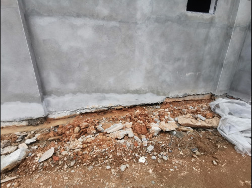

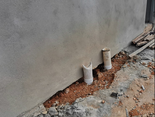

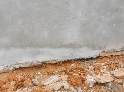

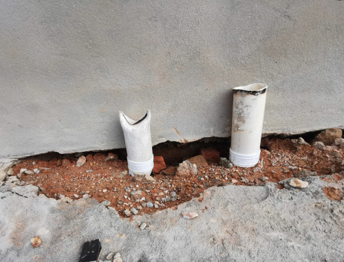

Hi everyone, just like to hear from you whether these gaps underneath the house are considered safe? Will the house sink or have other issues when construction is completed or many years in the future? Or are these actually normal?

ukiya21
post Mar 16 2025, 05:33 PM
755 posts
Joined: Oct 2008
From: Taiping, Perak
house no sink.. the ground are consolidating/settle...

Jazted
post Mar 16 2025, 07:15 PM
542 posts
Joined: Apr 2022
Any new construction nearby? New road or condo nearby could caused land settlement
Boomwick
post Mar 16 2025, 08:35 PM
1,006 posts
Joined: Mar 2019
Of cuz the best is all sealed up..
This one later rain water will cause soil erosion inside..
Or rat or snake, or wadever..
TSBananahead
post Mar 16 2025, 08:55 PM
57 posts
Joined: Feb 2023
QUOTE(knight_hawk @ Mar 16 2025, 07:11 PM)
Holes can become rat condo. Of course soon their friends, the snakes will come.
QUOTE(Boomwick @ Mar 16 2025, 08:35 PM)
Hope they'll seal it up later, construction is still on going. But if that's the only concern, then I'm fine with it, was more worried about the house getting damaged because of these gaps.

Boomwick
post Mar 16 2025, 08:58 PM
1,006 posts
Joined: Mar 2019
QUOTE(Bananahead @ Mar 16 2025, 08:55 PM)
Not at the moment
Ofcuz this gap when grow bigger will be damaging to the house, like u will get crack.. or water seeping in, so the cement floor always wet wet feeling
TSBananahead
post Mar 16 2025, 09:01 PM
57 posts
Joined: Feb 2023
QUOTE(ukiya21 @ Mar 16 2025, 05:33 PM)
Wait, I just did some google search on "ground settlement", but won't that lead to house sink and wall cracks?
QUOTE(Boomwick @ Mar 16 2025, 08:58 PM)
Is there something I can do before VP?
Boomwick
post Mar 16 2025, 09:21 PM
1,006 posts
Joined: Mar 2019
QUOTE(Bananahead @ Mar 16 2025, 09:01 PM)
Tell them lo.. make sure they seal it up by pouring in cement..
U know la.. short cut is just kasi do outside seal only. Hahaha
ukiya21
post Mar 16 2025, 10:39 PM
755 posts
Joined: Oct 2008
Normally terrace house is support by piling.. maybe 20m to 30m below the ground. so settlement rate will be different that unsupported soil. unless there's a massive ground movement, then your house should be ok...any river, dam, hill, water catchment area near your housing area?
This post has been edited by ukiya21: Mar 16 2025, 10:40 PM
TSBananahead
post Mar 17 2025, 07:38 AM
57 posts
Joined: Feb 2023
QUOTE(ukiya21 @ Mar 16 2025, 10:39 PM)
The nearest river is about 400 meters away, is that gonna affect anything?
November11
post Mar 17 2025, 09:59 AM
163 posts
Joined: Jun 2008
Same thing happened to my neighbor. There is a gap between the tar road and rear wall of the extended kitchen. Must be the result of soil movement.
During his 14 years stay, twice the floor tiles in ground floor exploded 💥💥. From kitchen to living room!
He only found out the gap appears after the tiles exploded ! He seldom survey back side of his house bcos rear door can't open ---> door frame tilted.
Twice he covered the gap with cement to prevent water goes in underneath his house. Contractor suspect hot weather causing hot air vaporation underground + soil movement --> tiles exploded!
Clueless07
post Mar 19 2025, 02:23 PM
1,372 posts
Joined: Oct 2012
Lol- best answer ever.
yes, if the house sink with the ground settle... then there will be no gap... tongue.gif
no gap dont mean no issue, means big issue..... lol
What will be the solultion? concrete/grout inject?
Nanti Sekejap
post Mar 19 2025, 04:10 PM
411 posts
Joined: Nov 2019
terrace houses in KV mostly do not sit on the soil itself, but sit on rc foundation
so the 'hole' wont bring any significant harm to your house
This post has been edited by Nanti Sekejap: Mar 19 2025, 04:18 PM
