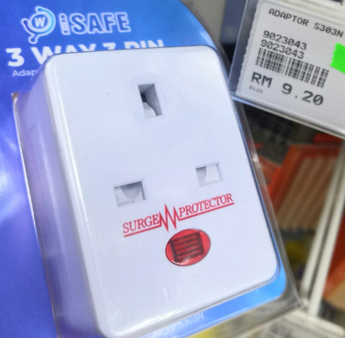

Hey everyone, is anyone using the surge protector from MR.DIY for your computer? I saw it yesterday but I'm unsure about its effectiveness. Would love to hear your thoughts. Thanks in advance!

You really want to trust your equipment with cheap DIY stuff

Don't. Inside no smart circuits, only cheap components like capacitors and resistors. Probably cost less than USD 1 to make.

Most common type of surge protection component used in surge protection device is MOV (Metal Oxide Varistor) or commonly known as varistor. I can 100% sure this is used in the device you've shown. There ore other type used on PCB like TVS, GDT, and Zener Diode.
The surge protector will clamp voltage over its rating by shunting the current to the ground. Therefore varistor or any other components mentioned is connected between L and N. Varistor has its own power rating or how much energy it will absorb before it fails. So, when voltage surge happened varistor (actually stands for variable resistor) will lower its resistance thus redirect excess current from L to N to keep the voltage to device within range.
Therefore, if the current (energy) is too much and beyond the varistor rating, the varistor will fail which means it behave like open circuit. Once broken, the voltage goes spike will go direct to your device.
So, it is not about MR.DIY. I think it will sure give the protection but depends on itsrating smile.gif Same goes to any brand. However, some more expensive one will have other circuitry like to disconnect the power line once a surge current is over certain limit, thus will safely protect the device in case of varistor failure.

QUOTE(acbc @ Feb 20 2025, 09:28 AM)
Even the branded one like inside power extension strip, there is nothing special but just varistor. No need to be fooled by brand name. smile.gif
Even my cheap Chine no brand one protect my plasma TV last time when many residents in my taman had their TV roasted sad.gif
