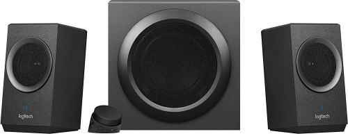

QUOTE(mrlabby89 @ Feb 9 2025, 09:04 PM) Hye. My Logitech Z337 suddenly stop working. Yesterday working fine. But today, no sound. I did notice the light at controller knob, dim a bit. Anyone know where i can send it to repair? I live in Sg. Petani. Penang also can. First, do the following troubleshooting to confirm whether its Speaker issues or not :-![]() 1. Plugin an Earphone or Headset, this is to confirm whether your Sound Card or Audio Out jack is working correctly. 2. Connect that Logitech Speaker to your Phone (if can) or another Computer or TV also can, this is to confirm whether the speakers is really having the problems. 3. Double check all connections such as Audio In jack (at Speaker side), Power Cord (Speaker) side, Power Point. This is to confirm its not cabling issues or insufficient power due to damaged Extension Gang or Power Cord. 4. If all else fails, then I would suggest to get a new set of Speakers of instead. It may not be worth the Time & Cost, but still your decisions to make. Hope this helps... |

QUOTE(mrlabby89 @ Feb 9 2025, 09:04 PM) Hye. My Logitech Z337 suddenly stop working. Yesterday working fine. But today, no sound. I did notice the light at controller knob, dim a bit. Anyone know where i can send it to repair? I live in Sg. Petani. Penang also can. Well, if the price is cheap (say sub RM500) then getting a new one is better than repairing.![]() Just turn the whole thing off. Disconnect the sub and unscrew the back panel. The board is usually attached to the back plate. Check for fuse, capacitor and amp chip. Usually leaking capacitor which lead to corrosion on the board. If board badly damaged then dont bother repairing. BTW, becareful and dont try to touch those high power caps... those 250v ones. This post has been edited by andrekua2: Apr 3 2025, 11:36 AM |
