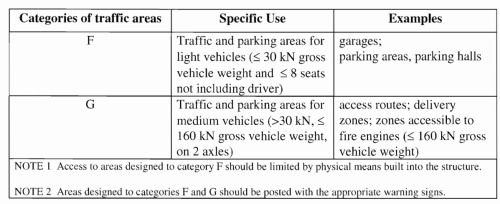

As an amateur structural eng, this question quite intriguing to me. Usually the carpark structures in Malaysia is design accordance to comply with categories F, which around 3tons weight or 250kg/m2 as an area weight. On top of that we will putting 1.5* safety factor on top to comply with some statistical probable situation as stipulate by the design standard. Hence, I would say nothing much to worry if the building is design and build appropriately to it's function.

QUOTE(dartchong @ Feb 5 2025, 03:13 PM)
yeah - good sharing.
din know there is this classification.
