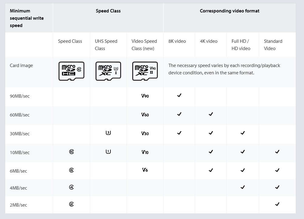

two main things, depends on
1) how long you want the footage
2) what is your video resolutions (full hd vs 4k hd)
price point of 128gb vs 64gb isnt much, i always tell my clients to top up abit just for more storage. better to have than not have
128gb roughly around 2 weeks of footage
for sd card, may refer to the table below. get a sd card with UHS speed card at least
