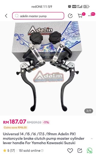

I'm using a chinese master cylinder, the brand is Adelin, around rm 140 on shoppee, these wont really improve the braking power but the braking feel is soooo much better than the spongy standard setup

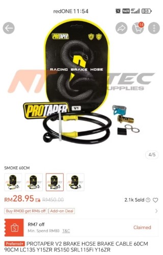

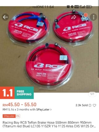

Im not sure if im allowed to post shoppee links here sweat.gif ,but here are the photos
If u want more peace of mind, u can get the RCB brake hose, but I havent really faced any issues with even the rm 10 unbranded hoses, my friend has been running them on a naza blade 650 with dual 4 pot calipers for over a year now, my XJ6 came with original Hel hoses, but the outer rubber coating gets rubbed off just as easily as the unbranded hoses if not routed properly.
The hoses with threaded fittings im not a big fan of as ive had them come loose and leaking on other bikes
The master cylinder I got the 17.5mm one but I think a 16mm is better so u wont have to put as much force on the lever to get the same amount of braking power
