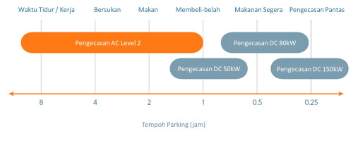

The power requirements for overnight charging should be lower.
You don't need ad DC 150kW at your parking spot.

lower power chargers work for overnight charging scenarios, but 150kW charger at your parking spot gives flexibility and convenience esp during unexpected moments when you need a speedy topup or only have so little time to charge. for shared parking spaces, it will really reduce wait times and congestion. my dua sen
