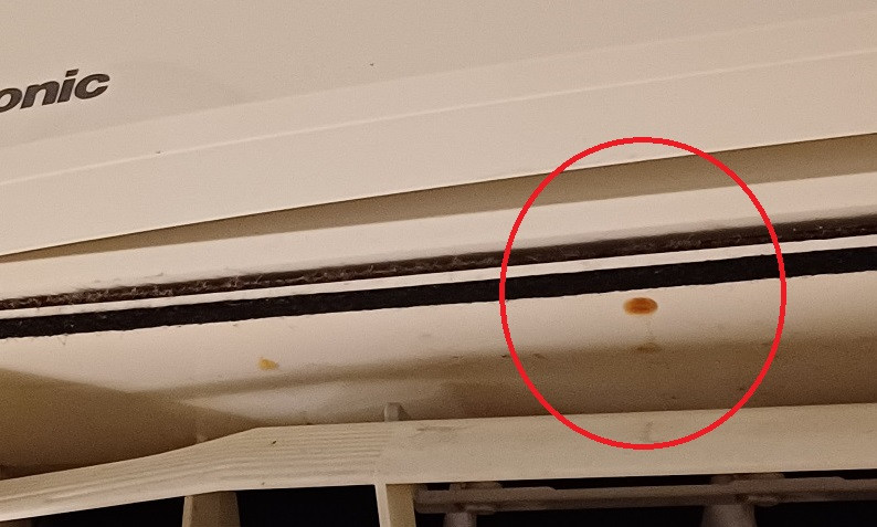

Is my air cond leaking oil?
Dec 14 2024, 09:44 PM, updated 2y ago

Cant see the oil from your pic...

Location of aircond? Near kitchen ? Dining area?
Open aircond when cook? This post has been edited by Boomwick: Dec 14 2024, 10:05 PM |

probably water + dust. Is this smoking room? Most probably it is.

Looks like dirty water. When is the last time the a/cond was cleaned properly?

how the smell ? mold or oil , you should differenciate it

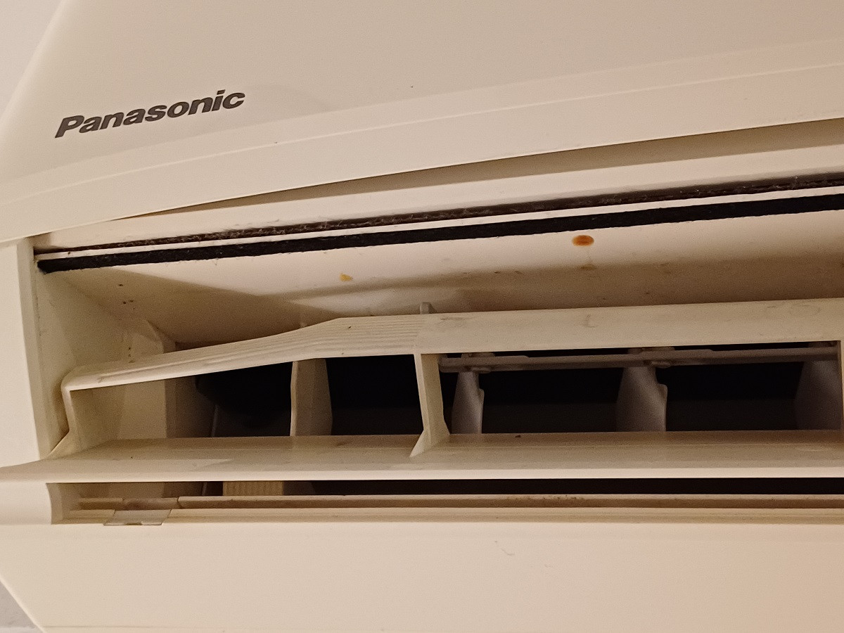

QUOTE(Boomwick @ Dec 14 2024, 10:04 PM) QUOTE(prophecus @ Dec 14 2024, 10:04 PM) living room. non smoker QUOTE(stormer.lyn @ Dec 14 2024, 10:29 PM) I only vacuum the heatsink. filter also very clean. once in 6 months.This post has been edited by Skylinestar: Dec 14 2024, 10:44 PM |

QUOTE(Skylinestar @ Dec 14 2024, 10:42 PM) Looks properly into the blade.. U might find that the blade is sticking dust already.. Most probably is cooking oil smoke or some other smoke like burning of incense oil accumulate at the dust on the blade.. So when u open the aircond, the roller blade roll fast and swing out those oil accumulated from the dust.. hence got those oil spot. Ur aircond is using cool mode right? Not dry mode.. Cool mode easy to see water condensation, hence easy makan dust LOvebugs liked this post

It’s the condensation mixed with dirt from inside the condenser

definitely the moisture + dirt + dust. Passed experience cleaning it DIY, using soap water mixture, spray it inside after open the filter for cleaning.

or TS, call service for AC cleaning. after cleaning, sure cold as new back, especially after clean the blower area from dust
