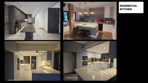

Some of our previous work for inspiration.

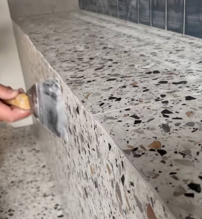

QUOTE(ycs @ Dec 30 2024, 01:46 PM)
whats the current method for kitchen counter top edge finishing?

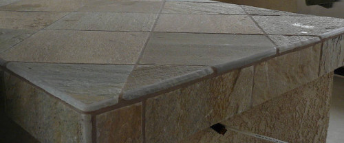

I assumed you were referring to kitchen counter tops using concrete top and tiles?
1. For edge finishing, you can opt for the traditional way - a slightly rounded edge.
The key tip is to use homogeneous tiles. This way, the countertop will maintain a consistent colour tone throughout, when your tiler trims the tile edge to create a half-round finish.
Sample effect:

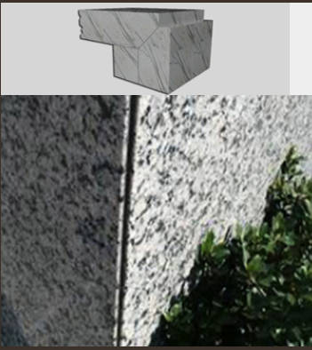

2. Alternatively, you can opt for 45-degree aka mitre edge cut on tiles to achieve a seamless edging. But to achieve a perfect mitre edge is not easy, hard to get local sifu who will be able to do it.
Local practice, usually only able to achieve a bird-beak effect.
Seamless 45-degree edging:
bird beak:
