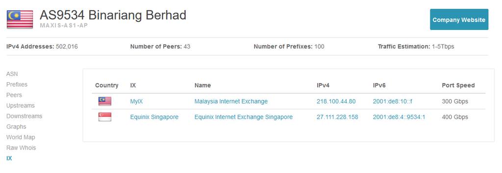

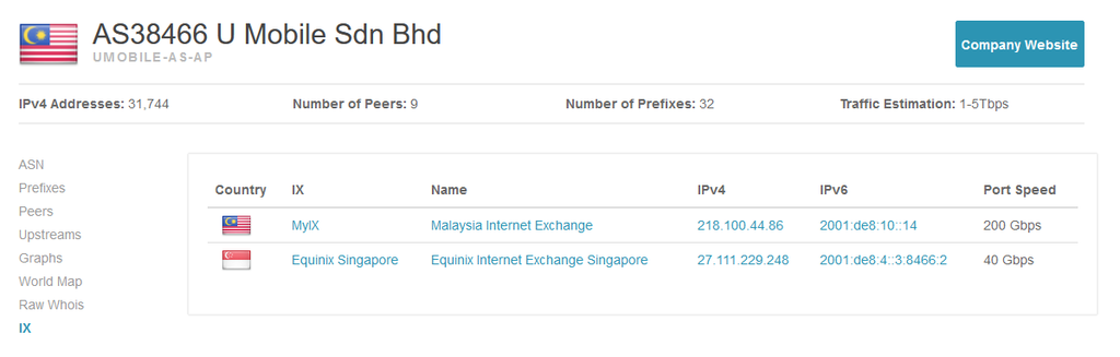

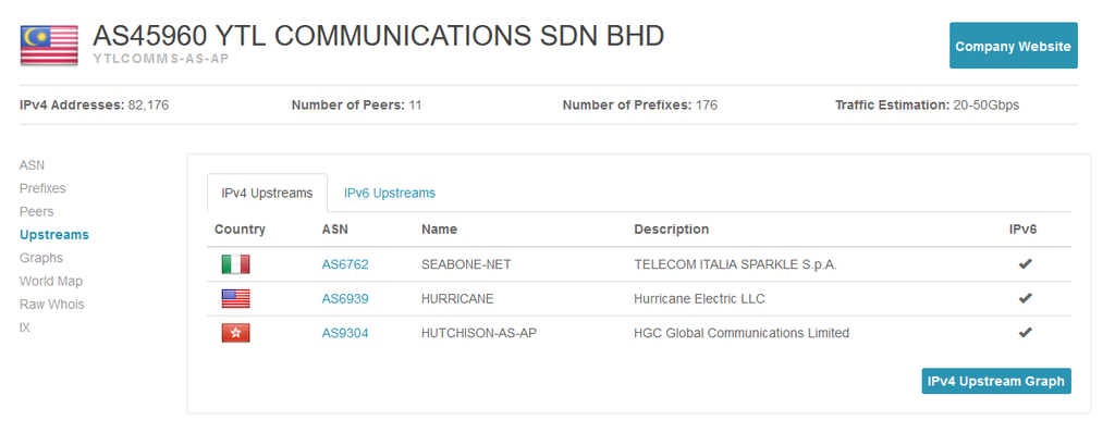

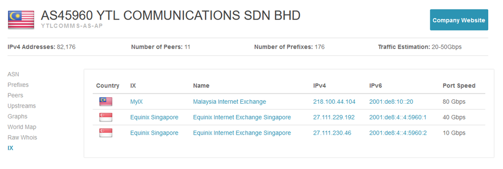

QUOTE(Johannlo @ Jan 30 2025, 03:03 PM)
Subscribed to CD Fibre 300mbps under TIME infra.
Realized the CGNAT policy on CD is very aggressive causing a lot of browsing issue even on Lyn forum.
My symptoms is always the first request to the website will work, then subsequent request to the same website timeout and fail.
Highly suspicious of the aggressive clearing of the NAT translation tables and high frequency of ports reuse policy causing browsing issue.
When the request fail, I quickly load the same request using incognito or VPN or cellular network, it loads instantly. Hence the problem is isolated to my home fibre network.
Before this on Maxis Fibre + public IP never had this issue.
Anyone facing the same situation?
Ah now that you know, this has to do with the lease time allocation and refresh of their CGNAT gateways becoming more often during peak hours.
To think a big company like SialkomDiGi employs inexperience monkey administrators who didn't see this coming or have not a single idea what they are doing..
When you're connected to VPNs or stream online radio/media, it's going to be a serious issue because every few mins (depending on traffic level) the connection will pause now and then disrupting your streams before resuming.
To give you how deplete and shortage CelcomDiGi which calls itself Malaysia's largest mobile telco after their merger, their IPv4 blocks is even fewer than Yes (YTL Communications). That is how serious it is!
AS10030 - CelcomDiGi 74k IPV4 addresses
AS38466 - U Mobile 32k IPV4 addresses
AS45960 - YES 82k IPV4 addresses
AS9534 - Maxis Communications 502k IPV4 addresses
For a company that is even larger subscriber base than Maxis, they have lesser IPv4 blocks than even a small ISP such as YES?
That is why they cannot even afford to sell public IP to their customers..only a handful so the recycling and refreshing is very AGGRESSIVE.
Time has like 742k while TM being the Wholesale ISP of the country has like 3.2M IPv4 addresses..

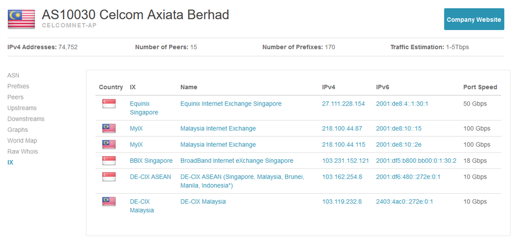

AS10030 CELCOMNET-AP - Celcom Axiata Berhad, MY
74,752 IPv4 Addresses
AS4818 DiGi Telecommunications Sdn Bhd.
332,800 IPv4 Addresses
how come digi have more IPv4 than celcom axiata ?
This post has been edited by JLA: Jan 31 2025, 03:30 PM

QUOTE(JLA @ Jan 31 2025, 03:00 PM)
If you combined all three Celcom + DiGi = CelcomDiGi,no where near Maxis's 502k.
