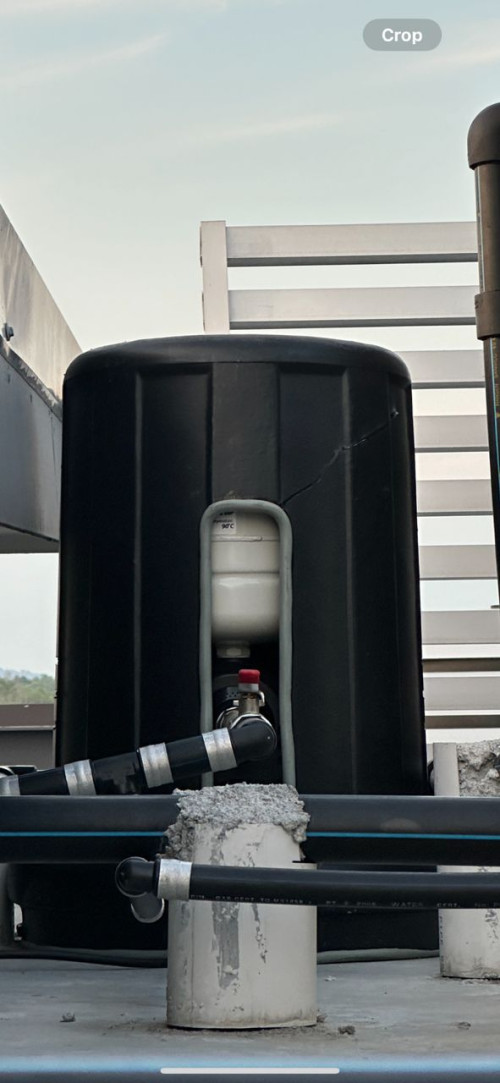

Gurus,
Need yr help with water pump for domestic usage...
Currently doing renovation and have plans to install water pump...
I am going to place my SS water tank outside at the backyard...
The pressure from the water tank is kinda low, so need a water pump..
Can the water pump be placed outdoors ? How to protect it from rain and shine ?

Put a roof / cover on it ?

Mount it higher up just under the eaves of the roof?

Okay...is it better to place it under covered roof ?
I would think so. A lot of the pumps claim to be weather resistant, but keeping something out of the weather usually is better for longevity for most items. Just make sure air flow is not interrupted so heat can dissipate from the motor
