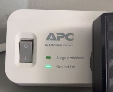

A couple of years ago, I posted here asking for recommendations on surge protectors, and I ended up buying the APC Essential SurgeArrest (5 outlets with 5V, 2.4A 2-port USB charger, 230V UK PM5U-UK).
Model: PM5U-UK
Link: https://forum.lowyat.net/topic/5143273
Last week, there was a power trip during a lightning storm. At first, everything seemed fine, but yesterday I noticed that the surge protection LED on my APC unit wasn't lighting up anymore. I remember the surge protection light was always on before.
The power strip itself still works, but I'm unsure if it’s still protecting my devices. I’m guessing it might have lost its surge protection capabilities after the power trip last week.
Could it be that the surge protector did its job and protected my devices during the storm? Really not sure since the light is now off.
So, I started looking for RMA information. I reached out to the APC Official Store on Shopee, and when I asked about the warranty, they immediately requested my receipt. It seems their products only come with a 2-year warranty (I bought mine from All IT Hypermarket).
The official APC website isn’t very helpful either – it only provides a phone number for support, and to contact them through the site, you need to create an account.
Their fbpage chat didn’t respond and also redirected me to their website.
In the end, I called their service hotline and got transferred a couple of times to the APC team.
Here’s the process I went through on the call:
- Verified the model and serial number.
- Did basic troubleshooting (unplugged and replugged the power strip, and confirmed the devices plugged in).
- They initiated the RMA and requested additional info via email.
- They said they would send me a replacement without needing to return the "faulty" unit.
The whole call took over an hour. Their customer service is based in the Philippines, and I found their English a bit difficult to understand at times. But after verifying everything, they confirmed that my unit has a 5-year warranty, which was a relief.
After the call, I got an email requesting my invoice for their records. I contacted All IT's customer service on Shopee, and they quickly sent me the invoice. rclxm9.gif
Overall, the process was okay. If the LED on your surge protector stops lighting up, I’d recommend reaching out for an RMA because it might no longer be providing protection. And calling their HQ directly seems to speed up the process!
