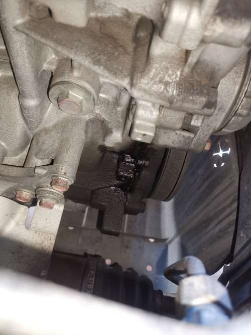

Can any sifu here help me identify which part of the engine is leaking engine oil?
Link to video showing the leak: Engine Oil Leak

Hi guys,
Can any sifu here help me identify which part of the engine is leaking engine oil? ![]() Link to video showing the leak: Engine Oil Leak This post has been edited by inkle: Oct 12 2024, 10:08 AM |

Probably timing chain cover , usually once the timing chain cover is open probably can reveal more leak , also don't forgot to check crankshaft rear oil seal got leak or not by removing the cover hole for remove torque converter nut if the design still same like any other automatic transmission.
This post has been edited by zuozi: Oct 12 2024, 11:00 AM |

QUOTE(zuozi @ Oct 12 2024, 10:55 AM) Probably timing chain cover , usually once the timing chain cover is open probably can reveal more leak , also don't forgot to check crankshaft rear oil seal got leak or not by removing the cover hole for remove torque converter nut if the design still same like any other automatic transmission. Thanks Zuozi, I will check the places you mentioned. |

Yes, you should get a proper mechanic to check. If you want to make it easier to detect, wash the engine bay clean first then drive to mechanic place, if really leaks fresh oil stain will show the actual leaking place more precise.

QUOTE(littlefire @ Oct 14 2024, 11:12 AM) Yes, you should get a proper mechanic to check. If you want to make it easier to detect, wash the engine bay clean first then drive to mechanic place, if really leaks fresh oil stain will show the actual leaking place more precise. His leak looks like quite minor. Most probably he will need to drive around for 3-4days after engine bay wash before the leak weuld manifest itself. |

Honda engine at high mileage? If yes typically the flywheel oil seal. And do it at one go for others seal replacement. Done mine at affordable price workshop in Semenyih (my dad's favorite mechanic) there.
