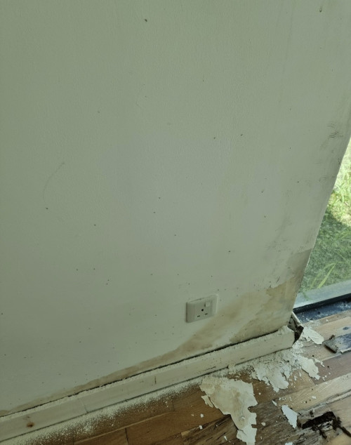

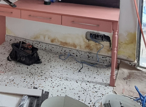

Hi all, need your help in identifying what is wrong with my wall. During reno, my contractor said he helped me applied some waterproofing solution to this wall under my study table (the exterior wall is directly exposed to the elements) without consulting me. At the time, whatever they applied to the wall, it stained the wall in bright yellow greenish and brown colour. Didn't think much of it as I thought it would be painted over.
However now we are in rectification phase, and they have spent hours of manpower scraping and painting over the wall and within hours the stain will just come back. It's very frustrating and the keep saying they will solve it but I'm wondering if anyone has any idea what's going on or ideas to solve? Thank you.
1.Before reno, the wall had issues. user posted image
2. After application of the unknown solution during reno.
3. Current situation, after multiple attempts to paint it over.

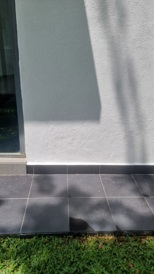

++Update++
Updated with pictures of wall from the other side.
The black floor tiles were added in by my contractor as a sort of barrier from the soil and grass as the wall used to terminate right at the grass.

QUOTE(dudester @ Oct 10 2024, 09:34 AM)
This looks like prolonged water seepage through the cement wall/pillar. you will need multiple coats to cover the mark. or paint a layer of sealers.
The house was unoccupied for 10 years so could be it. From the outside (picture updated in OP), wall looks ok? Just wondering if there's still fresh leakage or from years of seepage.

QUOTE(cedyy @ Oct 10 2024, 11:40 AM)
Does the wall feel damp? If it is, you'll need to solve the moisturiser problem first
Not exactly. That's why I'm under the impression it's the unknown solution the contractor used. I could be wrong of course.

QUOTE(Rorschach85 @ Oct 10 2024, 10:03 AM)
apply waterproofing on the other side, this can happen if no damp proof membrane is laid below the brickwall also.
Thanks for the suggestion will ask my contractor if this was done.

QUOTE(jiangchen @ Oct 10 2024, 09:53 AM)
As long as the source of water is not identified, I don't think it can be solved.
The water will just find areas that are not sealed well to go to.
I'm just stumped coz where the stains are, are supposedly treated with water proofing 😣

QUOTE(jiangchen @ Oct 11 2024, 10:44 AM)
Sometimes, those contractors are just finding the easy way out.
If the leak is severe, the wall has to be "opened" up partially to find the source, which will incur more money and time to fix the actual issue.
If multiple waterproofing failed to fix it, most likely have to part by part, break up the wall to find the issue.
My toilet had an embedded pipe which started to leak. Had to break open the wall, fix the pipe, apply waterproofing and seal up the wall, repaint. Tedious work.
The water seems to be coming from the soil to be honest. Your new front of the wall picture shows that the bottom part of the wall, even from the outside, has wavy pattern.
The extended black tile section may or may not help if the soil is wet due to long term exposure to water.
When my contractor fix my upper level toilet which is leaking water to the lower level, he used some thick waterproofing kinda cement as base.
You are right, I think due to the age of the house the ground water has come up or something. After some reading we have figured it's an issue called "rising damp" and it's quite a complex thing to solve. Been contacting multiple local leak/waterproofing "experts" but it's an exercise in futility. Hope to find an actual expert that can go with chemical solution rather than a renovation route, as we have just come out of a fully fledged reno. It's obviously very frustrating that this wasn't dealt with more thoroughly during the renovation, and the contractor only painted some dodgy waterproofing solution to the wall as "a favour" to me.
Well if anybody knows any contact that understands Rising Damp please send them my way thank you.
