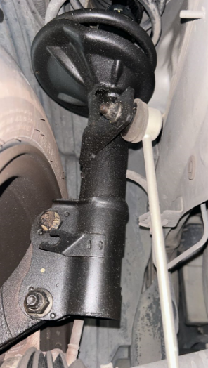

Me and wife's 11 year old Saga now making creaking sound, sent to dealer SC check,
found out absorber leaking kononnya, if wana change together with mounting, almost 1.2k
wanted to get other workshop opinion oso, how long can tahan ah?
just last month changed the driveshaft cost around the same, tiber ini buat hal sad.gif

from photos yes it sort of leaking from the shiny surface u see there. If you change outside u maybe can save abit on labour, I think the range should be around 800-1000 for whole set of 4.

QUOTE(ki_maxs @ Oct 9 2024, 10:49 AM)
but my wife was quoted for front left only and asked for 1.2k so i was skeptical
checking with them back whether they meant change = change all @ 1.2k

QUOTE(quartre88 @ Oct 9 2024, 09:54 AM)
If 1.2k for 1 side only then blardy expensive.
online price is 600+- for the whole set. add mounting is 200+-. then u need maybe 100-200 for labour

QUOTE(quartre88 @ Oct 9 2024, 10:42 AM)
had the same thoughts man, but because not confident enuf hence asked for opinion.
bos u got any contact around PJ/SJ/USJ for good workshop?
Just for reference I changed my inspira whole set absorber + mounting bearing at 1400+- IIRC at proton sc. maybe u can try and clarify back with the sc.

QUOTE(ki_maxs @ Oct 9 2024, 01:22 PM)
for other workshop at your area sorry couldn't help as I dont live there.
You can survey arround, google map review is quite helpful for checking their reliability.
wife asked the SC already, memang 1.2k for that front left part only thats why we thought why so sketchy
anyway got any idea how long would the leak tahan for now?

QUOTE(quartre88 @ Oct 9 2024, 12:54 PM)
been checking reviews in map that so far found results around <3.8 hardly for those nearby
SC usually charges 1 side. But people who know.. usually you change 1 side is not enough. Min both side.
Suggest you. go on Saga community group and search for a Workshop to get a quotation first. 1.2k should be enough to change all 4.
Also with the age of your car, suggest you to change all 4.

For 1200, u can buy original parts for all 4 sides, with bushings and mountings for the absorbers. Kena pandai cari original. Not shopee

Hi, for heavy stuff like 4 pieces of absorbers its a bit risky during transportation.
I suggest visit a car spare part shop and compare their prices. If its not too far off maybe can buy at these shops. Usually arent so expensive.
If wan jimat more, search for kayaba/kyb or monroe brand. Much cheaper below rm500 can get 4 absorbers. These are quite reliable and are oem for a lot of japanese makes cars.
Workmanship will be around rm200-250 for all.
