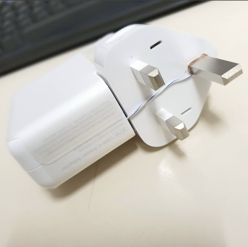

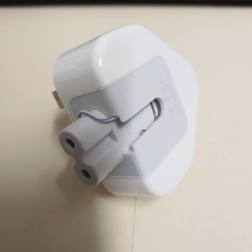

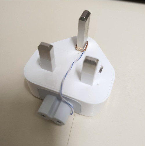

I have the same problem with a MBP 14 and 67W Apple Charger.
I found a simple DIY solution online, which involves connecting the earth pins of both the adapter bring and the 3-prong UK plug using a wire.
This will instantly eliminate the weird tingling/vibrating feeling when the MB is connected to the mains.
Here are some photos to show what I mean.
I am using one strand of the copper wire from an Ethernet UTP cable for this purpose.
You can also use cable ties with metal cores (those black/white coloured strips used to tie up cables), but I find that it breaks easily compared to the thicker wire from an Ethernet UTP cable.
Just make sure that the wire has proper shielding, except on the contact points between the 2 earth pins, and make sure that it never touches any other pins of the adapter and plug, except the earth pins.

Cool, didn't thought of doing that but I found out my 2008 macbook charger extension cable with proper earth connection fit perfectly with the 45w charger, no shocks after using that thumbup.gif
siaush
post Sep 9 2024, 03:41 PM
246 posts
Joined: Jan 2005
QUOTE(more2teayap @ Sep 9 2024, 01:41 PM)
