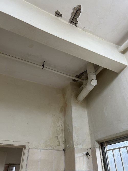

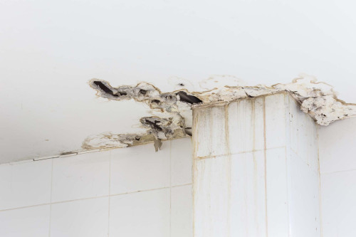

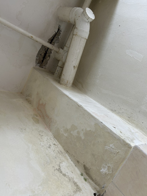

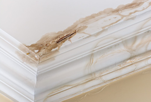

My terrace house have 2 toilets upstairs, both have leaking problem and cause the lower floor ceiling having cracks and rust. Pictures below are actual photos of the ceiling under the toilets.
A contractor told me this can be done by completely hack away and redo the floors of both toilets, add in water prooving. But this method will create a lot of havoc. I also heard of the new nano technology but don't know much about it.
Can sifus help me make a decision: traditional method / nano?
Front toilet:
Back toilet:

Old method hack with proper waterproofing = at least 10year no headache but lots of work and dust ,
New method less work and faster to complete but 3-5years problem come back

This one too far gone for nano treatment.
Still need to hack, redo the waterproofing and then redo the tiles. If pipes, need to replace all the leaking pipes.
As for waterproofing, don't use those water based ones. Won't last long. Opt for bitumen based. Stinks but will last easily 10 years. And when applying, make sure at least 2 ft from floor to wall too. Applying multiple coats just to make sure.

Need to identify whether it's the floor or pipe.
If floor, you can do Nano (if u don't want to hack option & redo waterproofing).. But this are temporarily fix, it will come back... Just don't know when only.

Just hack and redo the floor waterproofing. It will not be that messy since it is in confined space. I think it is just a quick job. Just hack shallow depth only on floor and few inches on wall inside bathroom.
Anyway, need to find root cause first. Was it caused by cracked floor due to house structure shift? Probably leak is just around the water outlet.

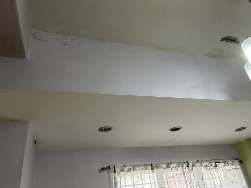

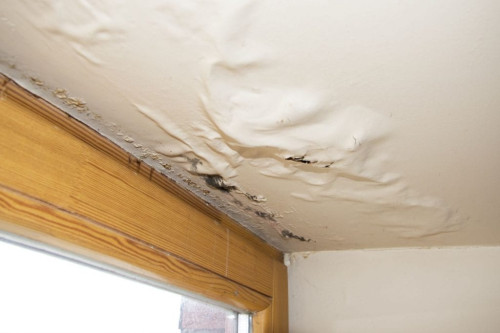

I get it that the epoxy part I can DIY. Now take a look at the actual photos of my ceiling downstairs, Do I still have to find contractors to repair these?
Front toilet:
Back toilet:
