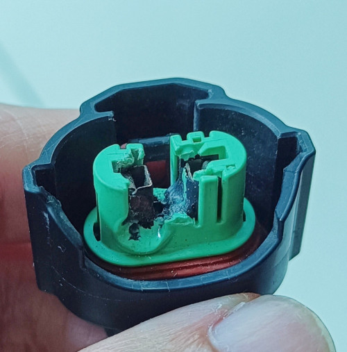

QUOTE(submergedx @ Aug 11 2024, 08:35 AM) My e class headlamp are dimming, checked via foreman the Headlight cord set plastic already melt dun understand what cord set plastic you talking about... can show the melting parts?Went both car accessories shop they told need to redo both headlamp wiring, but they say need wireman which they dont have. my case was loose connection/arcing causing socket to melt... diy replace for rm 6... ![]() lost of light output can be from oxidation/hazing of reflector/lenses, aging bulb or oxidation of connectors... just make sure you are spending on the correct problem... lsm1991 liked this post

1,134 posts Joined: Jun 2015 |
QUOTE(dwRK @ Aug 12 2024, 03:10 PM) dun understand what cord set plastic you talking about... can show the melting parts? my case was loose connection/arcing causing socket to melt... diy replace for rm 6... ![]() lost of light output can be from oxidation/hazing of reflector/lenses, aging bulb or oxidation of connectors... just make sure you are spending on the correct problem... ![]() Something like this, but more worst, the whole cable dont have the (black)plastic covered on the wire. The bare copper wire and tangling each other So sometimes when vibrated, the cable will triggered and disable my light, then sometimes will come back. |

6,251 posts Joined: Jun 2006 |
QUOTE(submergedx @ Aug 12 2024, 04:17 PM) ![]() Something like this, but more worst, the whole cable dont have the (black)plastic covered on the wire. The bare copper wire and tangling each other So sometimes when vibrated, the cable will triggered and disable my light, then sometimes will come back. yeah best to attend to it quickly... |
