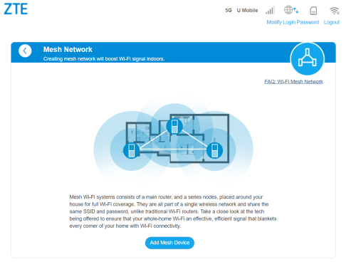

QUOTE(PRSXFENG @ Jul 19 2024, 11:22 PM) The best solution would be to just get a TP-Link X50 5G as your main node and have other Deco nodes for mesh If anyone has a spare MC888S for me to try it out... But it has its flaws and also cost I dont think U Mobiles provided stuff supports EasyMesh At least I see no mentions of it ![]() |

QUOTE(andrekua2 @ Jul 20 2024, 12:10 AM) MC888S is the umobile/xte modem/router ? The SIM slot which supports 5G sim, is expensive. So getting two umobile routers for mesh is waisting one of the SIM slot. The MC888S should form mesh with a (cheaper) router without SIM slot. |
