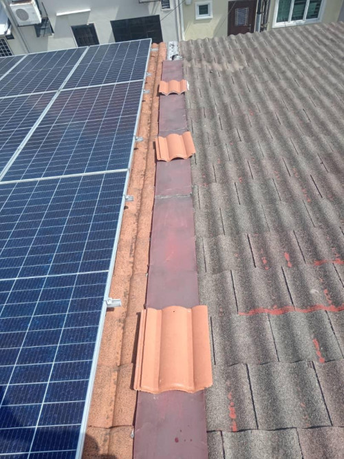

how much would it cost to just add tiles on the edge of a roof? I estimate about 88 tiles needed just to put along the edge to prevent leak and weigh down the aluminum sheet. shown in the photo currently 3 tiles weighing the aluminum sheet. tile cost 2.70 each so 100 is 270 plus labor maybe 300 for a 2 man team. is 600 enough?
