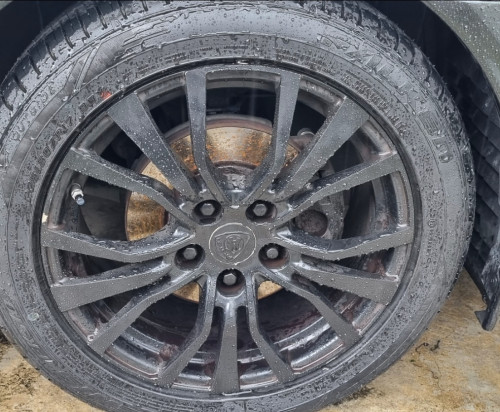

Was wondering if anybody knows any shops that provides service to enlarge the centre bore of rims.
Currently my car has a centre bore of 67mm, which is quite large, and that means if I am trying to replace it with a cheap 2nd hand OEM rim of another manufacturer/model, it likely won't fit. Enlarging the centre bore of the rim would fix this issue and give me cheaper alternatives.

Engineering shop can do but you need to know how much diameter u need

ktek
post Jun 17 2024, 06:17 PM
小喇叭
13,187 posts
Joined: Jul 2006
nobody want to do for me. so i end up buy boring machine with correct size bit and cutting it by myself
ktek
post Jun 17 2024, 06:20 PM
小喇叭
13,187 posts
Joined: Jul 2006
honda rim is aluminium. quite easy to shave off
follow directional order, check diammeter after each cycle
not worry about imbalance circle. becos mine isnt perfect. yet no effect on high speed/ weight feel
