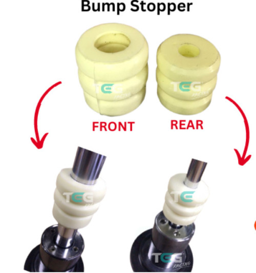

Hi all, i planned on changing my 7 years absorber to GAB HE Series. Would like to ask will the adjustable come with its own bump stopper? Or will reuse my car's absorber bump stopper. I planned on changing all absorber bush together since have to dismantle current absorber, to save future labor fee and double work in case any bush become fail.
It should.
Just that some installer, would stack and making it harsh.

QUOTE(bo093 @ May 27 2024, 12:36 AM)
It should.
Alright, i can skip buying new bumpstop then. Bumpstop stacking, cant imagine how harsh is the ride.

QUOTE(AliBaBa_King @ May 27 2024, 09:43 AM)
It depends some required cutting, some required removal, and some replace. Depends on the car and absorber. Suggestion no need to buy.. When change only see how.

QUOTE(JON97 @ May 27 2024, 10:19 AM)
Never ever cut bump stopper as it wil disintegrate easily after cutting. Just buy the lower type .

QUOTE(r3d2 @ May 27 2024, 10:25 AM)
In tein instructions they ask to cut hmm.. But mine when they install they didnt cut they just leave it as it is.
That depend on the material itself.
