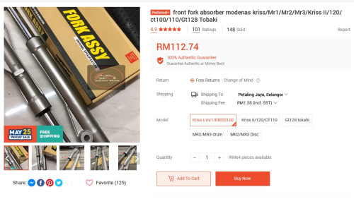

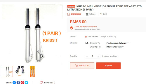

Anyone use fork that cost around RM70 (Shopee) before ?? I going to replace my damage fork so I like to know if the fork with that price usually last how long before the spring lost it's stiffness and effectiveness ?? 1 year at least ?? How fork like this compare to branded fork such as Tobaki (Shopee RM120+-) or Kayaba (Shopee RM160 ++) beside the warranty availability ??

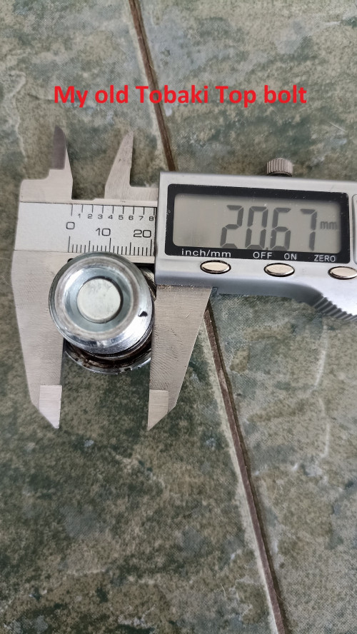

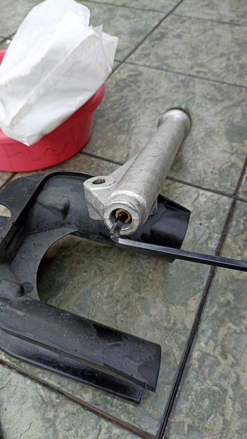

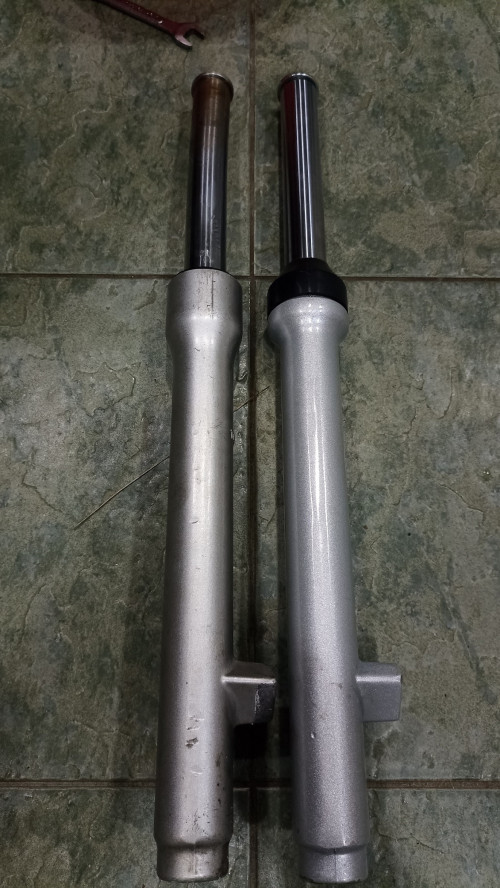

Already replace fork oil and testing my new OEM RM70 cheap fork for 2 days and this is so far what I got.
1. Drain out the existing darken oil yesterday and test with cheap Apido RM6 fork oil (Shopee include shipping) but the result not that satisfying so I redo the whole thing today using slightly better 15W Faito fork oil (RM23 from spare part shop nearby) and start with 50ML/fork see how the fork response when I go work later.

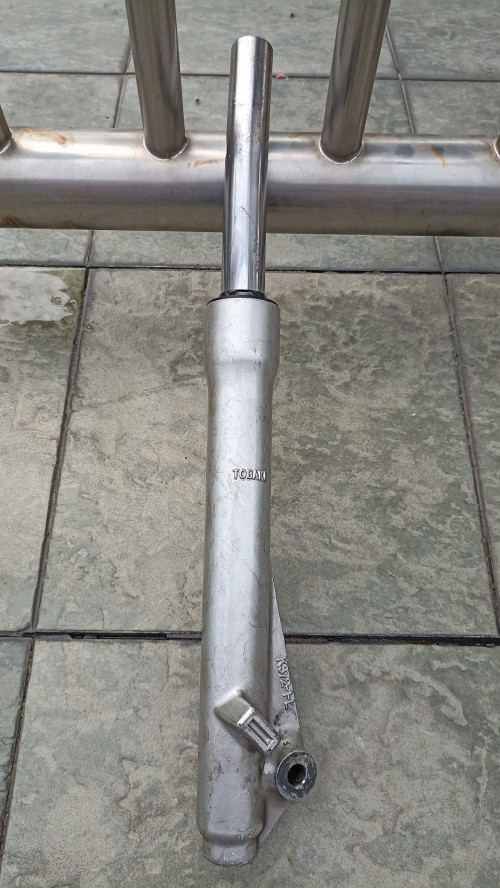

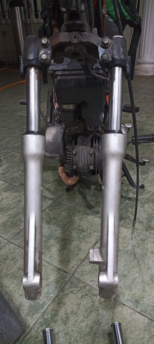

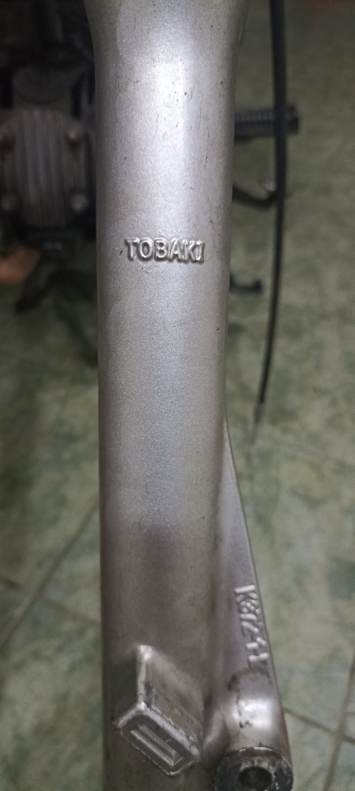

2. My old seriously damage Tobaki fork

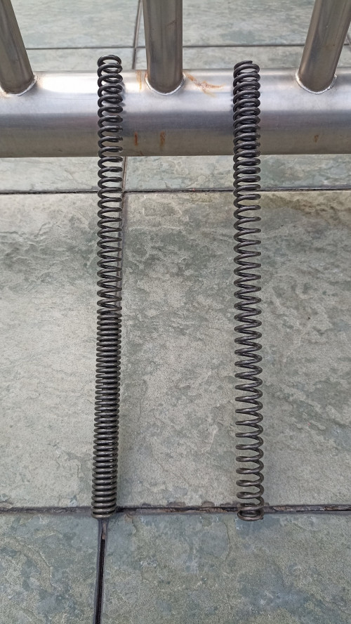

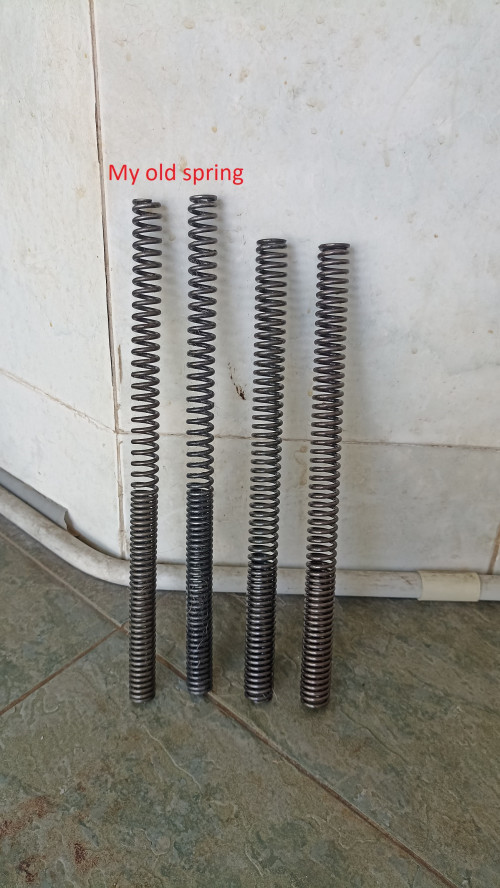

3. Tobaki vs Cheap fork spring

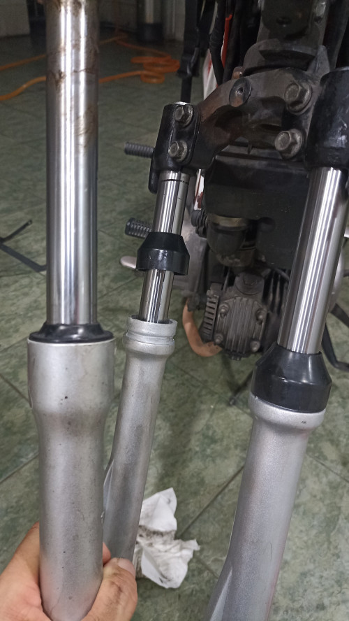

4. This cheap fork build quality definitely bit low. The cover it use is just some very soft type of thing and could easily come out.
5. Also fork did come with faulty issue the very moment it arrived. One of the fork bottom screw not working properly, can't tighten or loosen no matter what. Another example of "Cheap thing no good thing". No more cheap fork for me. Next fork will definitely go KYB.
That's it for now. Later will go test to see how the fork react to 50ML fork oil, the spring is definitely not stiff enough to begin with, another reason why it is cheap.

1. I don't get what you mean by "that's not how you open a fork tube". Just use the correct size allen key to open the cap on the top and I did just that, how wrong is that ??
2. Yeah I need the damper rod hold tool to hold the damper rod inside to tighten/loosen the bottom bolt but I decide to just order a new fork set and return this one. How the seller deliver this set of fork to me when both fork's damper rod are not tighten properly is beyond me and I don't think I wanna spend extra money on a tool to pay the price for their mistake.

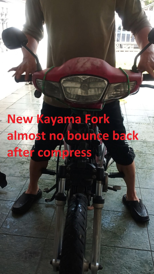

Already return the 1st fork set and call me bad luck because this 2nd order also has issues.

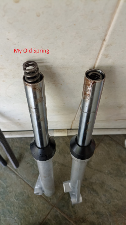

1. Spring too short hence not enough power to fully bounce back the fork properly.

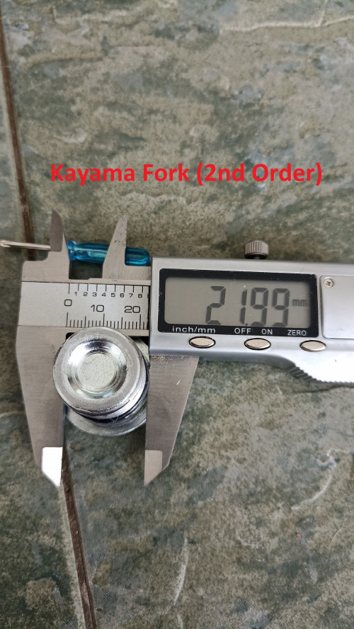

2. Top cap bolt bigger than usual causing it impossible to fully fit inside the steering stem.
So I have to order another set and return this one. Nice.

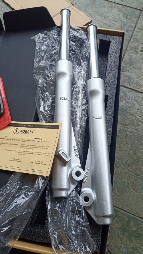

Looks like I finally answer my own question for this thread. Order 3 budget fork but all has problem so have to return while not willing to waste any more time dealing with the fork issue so go Tobaki again.
RM45 more expensive but I rather to pay more than purchase those budget fork again.
