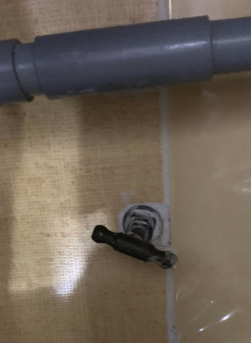

If the stop valve in the toilet is broken do I need to hack the tiles to replace it ? Any other alternatives ?

depends your tank is in the wall of outside the wall

The stop cock is malfunctioning. How do I replaced it ?

Must hack

QUOTE(LDP @ May 4 2024, 09:11 PM)
Open the top then u can replace it.

Is hacking really necessary to replace the stop valve ? I have asked a plumber and he said yes but then watching the YouTube Video above, it seems doable without hacking....
At the very least you have to hack around the tap itself to be able to release it. I don't mean hack the entire wall
