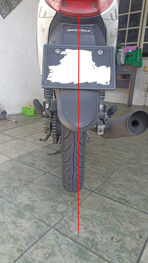

Is rear wheel offset like this easy to fix ?
May 3 2024, 09:29 PM, updated 2y ago
#1
361 posts Joined: Dec 2008 |
My rear wheel offset a lot to the left and I thinking to take off the tire and absorber and use something to pull the swing arm to the right to fix it but I wonder if there a better way doing it ?? Can't find any useful tips & tricks in google search,
![]() This post has been edited by bluecat68: May 3 2024, 09:30 PM |
May 3 2024, 09:51 PM
#2
2,003 posts Joined: Mar 2009 |
that looks like the frame/swing arm is bent?
no easy way but to send it to someone who has the machine to straighten it |
May 4 2024, 03:46 PM
#3
10,530 posts Joined: Nov 2004 From: Petaling Jaya & Mid Valley |
U should be checking alignment with the front wheel....nit the body...
Body plastics can sometimes be crooked |
May 5 2024, 01:58 PM
#4
My fork and absorber both get damaged year ago after a crash so check with front wheel won't work.
What concern me is that my rear wheel chain sprocket is not align with the front sprocket making the chain keep "eating" left side of the sprocket's teeth and making unpleasant sound so in case there are no better idea then I going to bent the swing arm myself then may be send to workshop if I fail. Now waiting my fork & absorber to arrived. |
