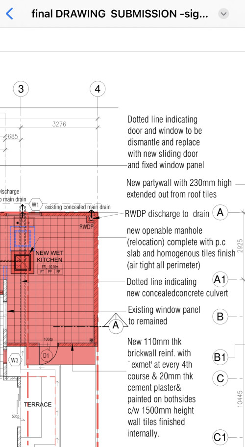

You can build your rear extension .. but make sure when you design your space .. example your kitchen area does not block the manhole area … and when submit to council the summiting person (sp) need to specify type of finishing with perimter airtight cover .
See example
Hope this help
Cheers mate

perimeter airtight manhole cover exists in local market?

QUOTE(absolut @ Apr 12 2024, 04:29 PM)
Nope … specially if you do PC slab with tiles finish no such thing the airtight perimeter …. I just share the submission I did for
MBsa ..Drawings just indication to follow officer specifications…. In reality -I have not seen manhole cover with airtight all round
Cheers mate
