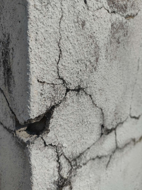

while making a deeper lines,.some part of walls chip off.
just wonder, can I put some stone in this hole ? Thanks
Do i need to put tape after tht.?
This post has been edited by teacherharvard: Apr 8 2024, 10:24 AM
can you put stone in the gaps of crack.walls?

Post some pictures

How big is the gap?

Put cement much better bro

I would suggest to use ASG stopping compound or USG before painting.
USG All purpose compound would be better. I repaired my external plaster crack using this one. |

Fill with mortar should be enough

Dig out the loose pieces and make new layer using 3-in-1 ready mix cement. No need to headache about the mix or lugging 50kg bags of cement. Just a few kg can liao.

cover with cement... good enough. teacherharvard liked this post
