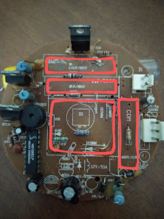

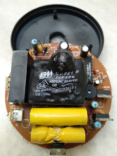

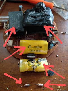

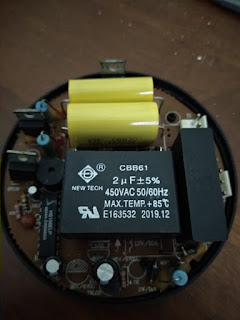

Alpha and Deka offered many choices, but in term of reliability, they are always having spoilt CBB capacitor (especially AC Motor Fan, unable to control speed or the speed becomes very slow). Anyhow, the Control Board modules are easily available, and might cost around RM100 (if you know how to install), or might cost only below RM5 (if you know how to change the capacitor). Most of these fans are using China module solution.

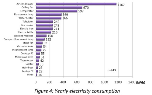

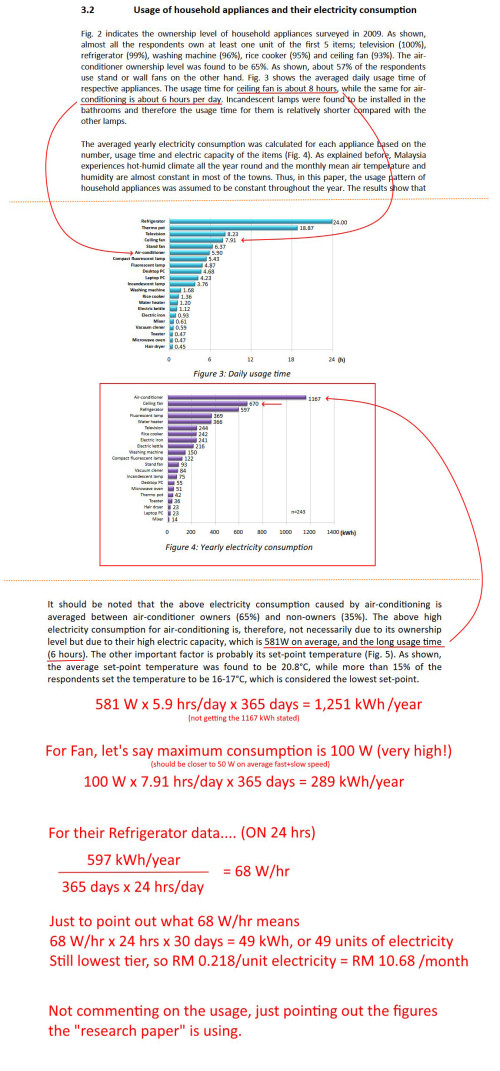

FYI, ceiling fan is among top 3 power consumming electrical appliances in Malaysia.
https://www.researchgate.net/publication/27...mxpY2F0aW9uIn19
