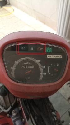

Hi-Low / Neutral & Top gear light not working .. so where to start to find the cause ?? (bulb is new)

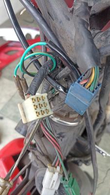

Masa tukar bulb tu ada socket empat segi kat dalam. Dari meter ke main wiring,ada double cek pasang ke tak bos ku?

Of course that is connected. But then if I check it with test pen most of them no current. Only 3 pin got current. 2 is for left right signal and one always got current not sure why. No current for the rest no matter if my bile is in neutral or top gear.
One pin always got current
I think my neutral switch is faulty but not sure what happen to top gear light yet .. need to google more when free. By the way Hi Low light very dim .. stronger light when accelerate the power and then go off when idle ...

Only one gear switch indicator (for Neutral & Top Gear light) next to the Stator. Either the switch is dead or wire cut somewhere but don't have time to check at the moment.
