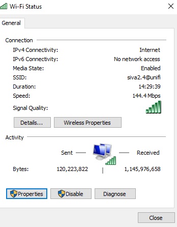

QUOTE(uni_lib @ Feb 28 2024, 06:19 AM)
open your network manager and check wifi speed there.
From router spec you suppose to get 100Mbps from 2.4G as well.
more thn 100 dy,, or should i check smwhere else? this is negotiation speed right?
This post has been edited by hdbjhn2: Feb 28 2024, 05:21 PM

QUOTE(hdbjhn2 @ Feb 28 2024, 05:21 PM)
Read here on negotiation speed.
https://community.tp-link.com/us/home/stories/detail/381

BUt I found out smthing.
Tried 40mhz from router page. Still same page.
Then i checked my adapter driver settings on device manager.
AND, while TpLink web page shows my adapter supports n mode, it does not show up on my pc.
same issue: https://community.tp-link.com/en/home/forum/topic/167518
and i can't find a way to fix this.

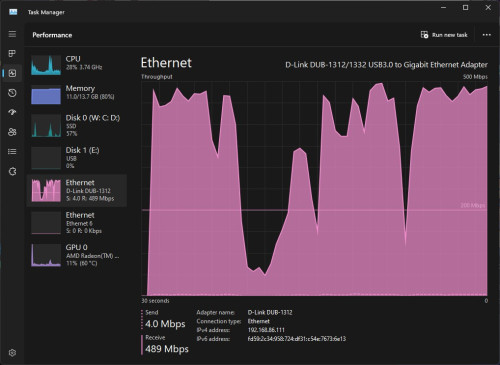

Ok lets test it now.
I have Unifi 500Mbps. Router is stock Unifi D-Link DIR-X3060Z AX-3000.
5Ghz Speed.
2.4Ghz Speed.
As you can see. The router can give very good 5Ghz speed, it just can't do anything for 2.4Ghz. A quick survey on Wi-Fi Analyzer, All the Channels from 1 to 11 are populated by 10 other access points around my area. So this band is very congested. Like i said, i have never gotten it way past 40Mbps in many places i tried. The max legacy hardware i tried it on was 750Mbps router on Wireless N. Still it would not budge pass 40Mbps. Now with latest AX hardware, it still will not budge pass 40Mbps on 2.4Ghz. Don't waste time on this.

Just showing What 5GHz router, RT-AC68U could do via bridge mode, network is 802.11AC 866mbps, then direct connect via USB-LAN adapter.
This router is really old that the power switch already broke, and dirty as heck, but i didnt throw away because im using Lappy and the internal WLAN is crap (Realtek 802.11AX) sweat.gif
PJng

QUOTE(1024kbps @ Mar 25 2024, 09:52 PM)

QUOTE(The.Lucas.DaY @ Mar 28 2024, 09:05 PM)
I can only get max 80mbps on 2.4ghz with Tm stock router, never achieve more than 100, i think that's limitation of 2.4ghz
80mbps is considered fast for decades old wireless standard, but the unbearable thing is the latency is high.
router and network plays important roles, i regualrly use remote access on other lappy for work, for some reason the latency is almost zero,
industrial router and latest wireless standard is really something.
