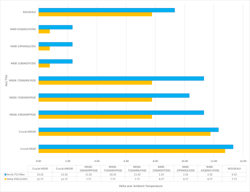

Objective of the comparison: Cooling down the 8 HDDs installed in my TrueNAS machine. The case I'm using is a Fractal Design Define R6. I installed 3x Thermalright C12 fan at the front of the case but I noticed the Toshiba MG06 drives were recording temperature of up to 58°C. I want to have my HDDs running below 50°C.

Temperature Comparison
The graph is showing the delta of the recorded mean temperature above ambient temperature. The fans are swapped and allowed to run for more than 2 hours to stabilized the temperature recorded by TrueNAS.
Summary
Both Delta FFB1212EH and Arctic P12 Max are far superior than the Thermalright C12 fans in terms of airflow and static pressure. The weight of the Delta FFB1212EH and Arctic P12 Max clearly shows that they are using a much more powerful motor. The Thermalright C12 just doesn't have enough static pressure to blow air through the small gaps between the wall of HDDs.
In general, the Delta fans are able to cool better than the Arctic, BUT the difference is not more than 5°C and the Arctic P12 Max is running at only 0.2dB above ambient noise level. The Delta FFB1212EH are running constantly like jet engines, whereas the Arctic P12 Max will occasionally ramp up depending on the CPU temp.
