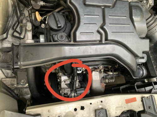

At this metal pipe. I don't see any other connecting points without paints.
I brought my multimeter along, able to sense voltage, from the body ground with respect to the (+) of the Bezza battery.
Also Bezza manual seems abit useless didn't put recommendation on where to clamp:

diffyhelman2
post Feb 1 2024, 03:26 PM
863 posts
Joined: Apr 2019
QUOTE(iSean @ Feb 1 2024, 03:22 PM)
Aiyoh. You connected to the aircon line., that’s not a good ground no wonder cannot jump start la. Next time connect out to the engine block, metal piece, close to the starter the better. Or the alternator also can.

QUOTE(diffyhelman2 @ Feb 1 2024, 03:26 PM)
I mean it managed to charge my car battery. I don't see any good raw metal without paint surface on my car.
I poked with my multimeter was sense some voltage through, thought it was okay sweat.gif
diffyhelman2
post Feb 1 2024, 03:29 PM
863 posts
Joined: Apr 2019
QUOTE(iSean @ Feb 1 2024, 03:28 PM)
This is my axia engine is almost similar. I always connect here ( alternator mounting point)
Yours might be blocked by the intake air piece ( black plastic) , just easily remove it and you can easily see exposed metal on the engine liao

diffyhelman2
post Feb 1 2024, 03:37 PM
863 posts
Joined: Apr 2019
And next time no need to wait 30 minutes to charge, just connect and start your car immediately. The idea of jump start is to by pass your dead battery and use the donor battery to start, if the connection all good and donor battery good condition ( and big enough) it should start easily.

QUOTE(pgsiemkia @ Feb 1 2024, 03:36 PM)
[/spoiler]
Good advice. Just want to ask who teach you to connect (-)neg to car body? Apek bawah pokok? Car paint these days already block the connection, also longer route to the battery. I wud suggest direct connection to the battery like in pix, ask the keta hidup to rev car engine first before you attempt dead battery start. Have been helping ppl a lot to jumps start car, even pregnant women who know how to isi minyak and drive saja..Pity nowadays many also dunno how to jumpstart a battery.
*Unker missed the days where you could put car in neutral and jumpstart car in 2nd gear. Maybe CTR or Megane?
agree on the connection
but
connect to body is safer
especially to car that have AGM or EFB
benz they even cover up the negative terminal just to prevent you jump start thru direct connection
This post has been edited by fantasy1989: Feb 1 2024, 03:57 PM

QUOTE(iSean @ Feb 1 2024, 03:42 PM)
" Just want to ask who teach you to connect (-)neg to car body? "
> Google any how to jump start, even Perodua Manual state (-) to raw conductive ground of car metal body.
If (-) to (-) will have the risk of Hydrogen gas leaked and caused a spark.
Otherwise, shared if Battery is shorted internally just fry two cars only.
Nah, if not done b4, let someone who has done it before do it that's why noobs try and fry cars. Just dun touch the car body with other hand when doing it also. Now batteries mana ada hydrogen gas? All acid free, maintenance free..

So directly I go survey another Battery shop RM 290 - RM 20 Trade In. Only just saved RM 5.  sweat.gif
At the end, I think should have let Carput to replace me car battery. In case next time or under warranty period the battery became dead.
Car Batteries nowadays so weak, can't really last more than 2 years+ already?  sweat.gif
My stock battery is some Panasonic Lead-Acid Battery with Refillable Caps.
Only went to Perodua Service Center 3 months ago, the technicians checked the battery report says ok.
I go look back report in details mana pula cold start Voltage was 10V+ but Engine started it was 14V+....
Rated CCA 240A, Measured already 220A...
The Perodua SC didn't bother to inform my battery near dying stage... rclxub.gif

Actually just use jumper cable connect to the connection at the dead car can dy don't have to connect to battery . At least this way u can reach home then buy car battery later .

QUOTE(MrBaba @ Feb 1 2024, 07:48 PM)
Well concern maybe got arcing or battery explode or battery is considered "shorted" state.
Will short out the car electronics, and ended up the with 2 cars with flat batteries or shorted electronics later.

QUOTE(iSean @ Feb 1 2024, 08:01 PM)
Actually u know how the battery work or not ?

Rule for jumpstart I kept in my mind
1. Make the jumper connection on the bad battery first and on the good battery last. This way, spark will only be at the good battery, reduce the chance of explosion
2. Jump start with the jumper car turned off. Don't want both alternator running causing potential electronic damage
Can also consider to keep supercapacitor jump starter. Cool tech where it can take the juice from your low battery, cranked up the voltage and start your car (working principle akin to camera flash) . No periodic charging needed like powerbank.

always use a bigger battery to charge the dead battery. You cant expect a Myvi battery to jump start a Merc battery....and pls...use THICK cables!
Mechanic love to use portable jump packs to jumpstart customer's car, and these jump pack has battery which are half the size of myvi NS40, jump pack may have something like 18-22 AH battery while a NS40 can have 35-40 AH. And yet those thing are perfectly capable of jump starting car with bigger battery like DIN70 and up. Thus a NS40 is more than capable of doing that.
