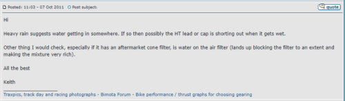

have you check the air intake/ filter part ? like my experience is drive through small river the water somehow get in or the air intake part got jammed then no smooth air flow go in so the engine die at the spot, after dry abit or start a few time then no issue again,
or the engine sealing glue already too old (which less likely is this issue
did your bike pop alot of white smoke maybe ?

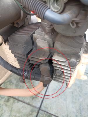

What is plug cap ?? This (1st Attachment) ?? If yes then change the whole cable ?? By the way why leak now ?? I didn't see any hole or something like that along side the cable. Also this cable connect to this components (2nd Attachment) .. should I change that together ??

yes, plug cap
leak when got water splash to it, then the plug cannot ignite becoz water short circuit the spark to ground
just change plug cap, google for pic, search shopee for pic
just unscrew the plug cap off the old cable and screw on the new one

The thing is water splash to it every time when it rain all the past 10 years and suddenly it causing short circuit now ?? To be honest I not getting it without convincing explanation.
By the way pls note the problem is "Bike losing power and even shut down in heavy rain" not "Bike can't ignite in heavy rain" if that make any different.

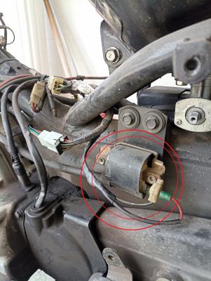

What is plug lead ?? The cable which connect to the plug cap ?? This >> ??
And since the other end of the spark cable connect to this then I guess this is the coil ??
I see no hole or crack alongside the cable though. Nvm will definitely change it if my current new taught method by a foreman not working. He say that's very normal because rider like me who work delivery very often drive under rain and carburetor will eventually get too many water inside by leaking somewhere or moisture effect from air filter especially I found out my air filter foam actually totally destroy like it never there (10 yrs never service or replace the foam). He open the screw which located at the bottom of my carburetor and let those fluid came out a little bit and there indeed water inside along with the petrol but I never has chance to find out if the method solve my problem because no heavy rain this 2 days the time I work. Somehow problem like this might explain why most rider will choose to stop and wait instead of continue working when the rain get heavier, may be most of them actually having the same problem but don't know how to solve it.

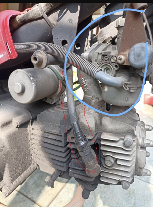

let the engine run with double stand
take a hose, and splash water the the plug cap is and see
he open the carb is fuel at the bottom, of course fuel will leak out there
he need to collect the fuel, and check for water
suggest you service the bike properly and thoroughly

He didn't guarantee that is the solution but the fluid that came out from the bowl does contain water and he tell me just try again and see how and yesterday evening I have a chance to test it under medium-heavy rain for about 2 hrs travel and that problem didn't happen at all. Coincidence ?? Guess I need another 1 or 2 heavy rain trip to find out.

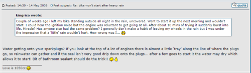

The concept is similar to car
Sparkplug cable is not 100% water proof type of thing
Last time car engine with standalone ignition coil, then distributor then distributor cap then spark plugs cable into spark plug
Every time if engine wash at non experience car wash or user error even for modern vehicle can lead to missed fire if there are moisture
Unless you glue whole thing up which have very high heat resistant hard like rock then everytime spark plugs change you got to replace the spark plug cable together
If ignition coil also masuk air got moisture you can also seal it up the concept it's similar to submersible water pump if you know what I'm talking about 😂😂

Even the blue circular part the carburator gasket failure ada air hujan air masuk also can stalling the engine if you ask how to masuk air because it's considered breathing air in of course can masuk air
Gasket it's not a forever seal Prof of thing if you wonder why now only rosak just like you shoe wear and tear when your shoe dah bukak mulut buaya you either glue balik or tukar shoe baru
