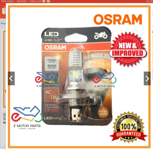

@TS
for your kapcai, just get those osram LED bulb, less headache and no external heatsink to deal with
many ppl use it, maybe you don't realize it
for older kapcai, the lightbulb and brake low light are using AC power so halogen is actually better

TSbluecat68
post Jan 22 2024, 07:23 PM
361 posts
Waiting reply from seller if this work for my Kriss MR1.

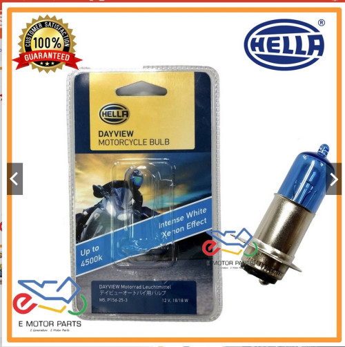

TSbluecat68
post Jan 22 2024, 10:08 PM
361 posts
So the seller reply saying that bulb is not for my bike but recommend this one. Excellent choice ?? Brighter than the original halogen one ??

QUOTE(bluecat68 @ Jan 22 2024, 10:08 PM)
Any halogen bulb with blue tint will only make the light look whiter, but you will lose usable brightness.
Unless the bulb uses higher wattage, but then this will fry your headlamp wiring.

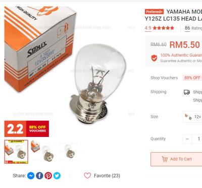

post Jan 26 2024, 12:41 PM
361 posts
QUOTE(skyblu3 @ Jan 25 2024, 07:14 AM)
In other word normal bulb like this is the best way to go for bike like Kriss MR1 ?? Bright enough and no heat issue ??

QUOTE(bluecat68 @ Jan 26 2024, 12:41 PM)
No idea
You should see the ratio of power to lumen rating.

QUOTE(bluecat68 @ Jan 22 2024, 07:23 PM)
Or you can run over to any bike shop and ask if they have dual colour LEDs
