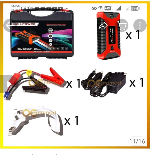

bereev
post Jan 20 2024, 03:08 PM
257 posts
Joined: Dec 2011
trusol

Can use this to jump-start?

QUOTE(MGM @ Jan 21 2024, 09:02 AM)
Can. But actually dont even need this. We have the v2l cable, just plug that in it would force the big battery to wake up the 12v battery to recharge them

derebanz
post Jan 21 2024, 03:57 PM
14 posts
Joined: Dec 2016
QUOTE(trusol @ Jan 20 2024, 02:48 PM)
Not sure why they didn't use LFP as the starter battery instead of the old-style lead acid battery. Lead acid batteries have a very short lifespan. Probably to cut some costs.
But luckily...
BYD announces to stop using lead-acid starting battery
They are the first to announce that. Hope other EV makers do the same.
This type of battery? It is more expensive though.
yeapsc73
post Jan 21 2024, 04:05 PM
382 posts
Joined: Mar 2009
QUOTE(derebanz @ Jan 21 2024, 03:57 PM)
Similar. Not sure how long byd LFP battery will last but Tesla one should last a life time according to Tesla

post Jan 21 2024, 05:30 PM
359 posts
Joined: Sep 2015
It is more expensive, which was probably why many EVs use lead-acid batteries as the starter. But since BYD manufactures LFP batteries, its cost should be lower than others, so its decision to get rid of the lead acid battery is easier.
