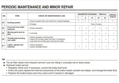

my bike Yamaha FZ150i is 10yo next year.
all these years, i just do the basics/minor maintenance such as oil n filter change, battery, breaks pads, tyres, chain n sprocket, etc follow the list that in the user manual (but not all lah)
so far, the bike runs ok IMO.
other than the maintenance listed in the user manual, what other things i should do for my bike that's almost 10yo next year? i read somewhere overhaul needed for old bike, but idk if i should do it or not.

Overhaul is not a maintenance thing....its a repair thing...no real need to overhaul unless ur bike is super high mileage n u may need to hone the cylinder walls, only if the condition is bad. Otherwise, overhauling is mainly to tear the engine apart n replace a broken or worn part.
Age by years doesnt determine the need to do this n that...except maybe for the fluids n some plastic parts that might deteriorate... Mileage is what mainly determines the need to do something.
Can just follow ur manual by mileage n u should be fine unless ur bike.
Depending on mileage, id do a valve clearance check or some mechs refer to as grind valve.

1- some engine oil kinda disappeared(?) a little everytime i change oil around 2-3k. read somewhere online it's common for my FZ version.
2- pickup not powerful. i think need to change fuel filter & air filter.
QUOTE(mADmAN @ Jan 19 2024, 01:33 AM)
my bike 61k mileage. what u think need to do?
what the valve clearance check will do?

The FZ is basically a simple bike with cheap plentiful parts.
Bike only needs an overhaul if you are massively loosing oil or coolant or have loud knocking noises...or the engine doesn't run at all.
Beyond that, just regular maintenance will do. About the only other thing engine related is to do a valve clearance check.
As for loosing oil, sometimes it depends on the oil and the viscosity you use. Some brands resist burn off better than others..sometimes your engine just needs thicker oil, especially older ones with higher mileage.. I was loosing about 250 to 300ml every 5000km OCI, on motul 5100 10/40 but don't loose any on my Mizu 15/50 both full synthetic.

that's nothing to worry about
- use fuel injector cleaner, change spark plug
- EO makan - change different oil brand, what spec you use? 15W-40?
- can consider valve clearance, but so far I don't hear FZ/LC having this issue - main symptom is difficult to start, and idle not stable due to exhaust valve unable to close properly

VC may cause exhaust valve to overheat and burning EO
injector cleaner and TB (throttle body) service is kinda needed sometimes, esp if owner remove air filter or mod it
for VC, can just ask for quote among service center and bawah pokok, and if got any after service warranty
I would want a reputable shop that can guarantee their work

tbh, on other bikes where parts might cost significantly more, then yes id recommend a topset overhaul to prevent further damage. In FZ's case, id just use it till the engine breaks down, then have it rebuilt, as the parts are cheap and plentiful, heck you can just spec it up just for fun without it costing too much money as aftermarket components can be found in almost all ali, ah seng and muthu shops.
10 years bike, consuming 1/3 of oil engine oil, that's not something a VC or filter replacement could fix. Unless you can get a real good bargain for a topset overhaul, id just ride it till it breaks. You prolly have a leaky valve seal or a worn piston ring, whichever the case, you'd have to open up block/head to fix.
As for other things you can do make it ride better before the need for an overhaul (assuming you keep basic maintenance in check)
You mentioned engine stalling and unstable idle, this is probably dirty throttle body, ISC, or fuel/air related, could also be bad ignition coils. Worst case could be due to low compression, a shop that knows that they're doing can run a quick compression test, and will take less than 5 mins, doing a compression test eliminate engine factor in troubleshooting.
