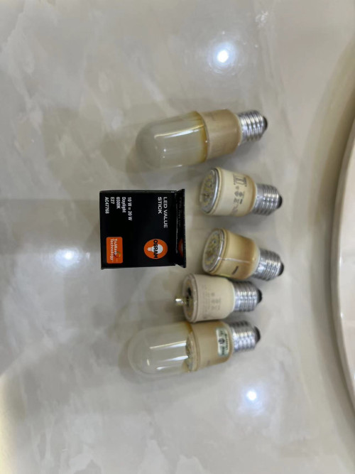

 Why my LED light bulbs keeps failling, Osram E27
TSviruz
post Jan 16 2024, 09:10 PM, updated 2y ago
820 posts
I thought LED light bulbs supposed to last very long but for me it rarely last beyond 2 years and most failed within a year, it will turned yellowish and start to break apart.
Currently using OSRAM E27 as downlight with reflector.

QUOTE(viruz @ Jan 16 2024, 09:10 PM)
Based on the photo, the bulbs are installed in a very high heat area, hence you can see the base has turned yellowish/brownish.
Not the quality of the lamp, it is the application environment.

QUOTE(brutus @ Jan 21 2024, 02:14 PM)
so how then?

Check neutral line properly connected on the housing or not ,

post Jan 22 2024, 09:53 AM
2,199 posts
It's too hot.
How and where you install it?
Stuffed in non ventilating place?
You may drill some hole at the casing to help ventilation
But do it very carefully

brutus
post Jan 24 2024, 09:51 AM
1,743 posts
QUOTE(nexona88 @ Jan 21 2024, 03:33 PM)
so how then?
Cannot comment if the installed bulbs are unknown.

qwerty223
post Jan 30 2024, 10:49 AM
786 posts
Joined: Jun 2005
toasted by itself. Your need to change casing with more ventilation
