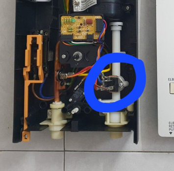

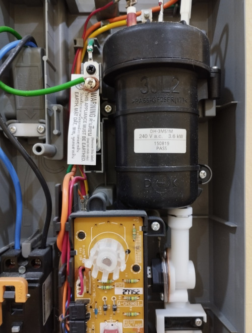

Just now, on 6th Dec 2024(Fri) at 11:30 PM, there was suddenly no hot water coming out from the water heater while I was bathing.
I pressed the black button on the left side of the water heater, and now the hot water is working again.
Why did this happen?
Water heater leaking issue 2nd time at 2024
The electric board of the water heater burned.
That day, it smelled very bad.
The whole house could smell it.
Why?

why inside wet ??.. u go and wash the wiring ??..
SUSCincai lar
post Jan 6 2024, 12:44 PM
113 posts
Joined: Apr 2019
u better blow dry the interior with hair dryer,.. b4 u sambung the power,..

even the PCB area is wet,..

Something very very very wrong in those pictures. I am not surprise someone would get electrocuted.
Is this normal design?
I don't recall the Panasonic I use have so exposed wiring and connection.

No,.. u must connect earth to earth (green),..neutral to neutral (blue),.. live to live (brown),.. else the ELCB won't trip if shorted,.. and u'll get electrified water,..

Throw away that water heater. wires connectors all already turning brown and you still using it ?
3 cores cable entry from outside casing

interior shouldn't be wet,.. not only PCB and connecter ,..

Please advice which part wrong..

a few concerns..
why internal all wet?
possibly the old wiring too short, you will need a longer wiring
best to dry everything and leave a few days before even try to switch on
presently, in current state, it’s very dangerous

the wet interior !!!...

then why all the wiring , connector and PCB is wet ??.. u got check the technician license or not ??..

Why inside of this water heater look so cheap, I believe there are no safety features in it.

TSplouffle0789

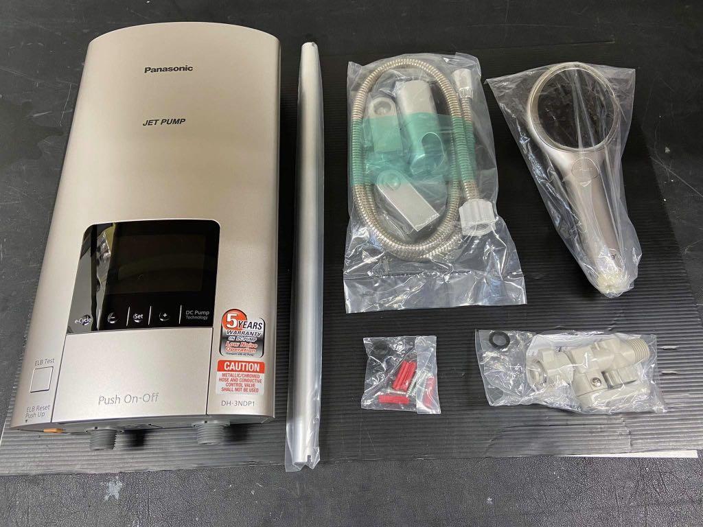

Joined: May 2010
QUOTE(TanahGagal @ Jan 6 2024, 01:39 PM)
Better use Panasonic
Panasonic inside wiring any special?
keyser soze

incoming wire from above. If water spray on the wire, due to gravity will flow inside the water heater then gg.

QUOTE(plouffle0789 @ Jan 6 2024, 01:48 PM)
TSplouffle0789

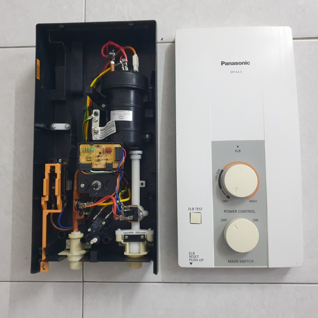

QUOTE(keyser soze @ Jan 6 2024, 01:51 PM)
Why manafacterer never cover life and neutral wire but not cover Ground (earth) wire?

QUOTE(plouffle0789 @ Jan 6 2024, 01:56 PM)
nothing special. The problem mainly is the outside wire. Water will follow the wire into your water heater if the wire is at high level.

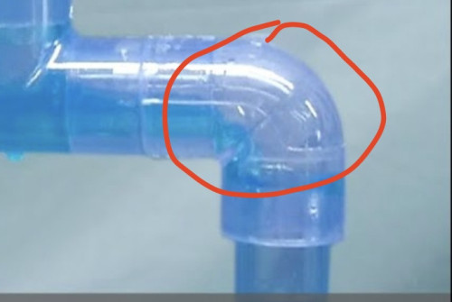

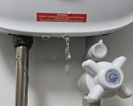

Is there a lack of a bypass pipe connected to the hot water outlet pipe or the cold water inlet pipe?
Because now just 3 months,this heater spoiled again.
Big leaking issue.
But this house water pressure is very big.....
This post has been edited by plouffle0789: May 28 2024, 09:09 PM

If this happen 2nd time, the heater shouldn't be use anymore. The plastic pipe is weak and cannot stand the water pressure.
Got to check the actual water pressure. Find a better spec heater that can stand the pressure.

QUOTE(ozak @ May 28 2024, 09:37 PM)
This is not plastic pipe.It is metal

QUOTE(smallcrab @ Jan 6 2024, 01:59 PM)
Why so stingy man
May I know do this house lack 1 bypass piping to hot or cold water pipe?

Rusty Nail
post May 28 2024, 10:14 PM
Why am I still here?
4,883 posts
From: Petaling Jaya
QUOTE(plouffle0789 @ May 28 2024, 09:59 PM)
New
Joven brand
why do you need a bypass?
kswee
post May 28 2024, 10:16 PM
577 posts
Joined: May 2012
QUOTE(plouffle0789 @ May 28 2024, 10:59 PM)
New
Joven brand
No need bypass, this is not process cooling.
Replace the heater and don't use steel pipe connector use PVC instead.
Add one manual valve for cold water.

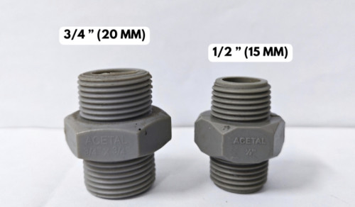

TSplouffle0789
post May 28 2024, 10:40 PM
1,836 posts
Joined: May 2010
QUOTE(kswee @ May 28 2024, 10:16 PM)
1) Why can't we use a steel pipe connector and instead use a PVC pipe?
2) Do you work in the HVAC (Heating, Ventilation, and Air Conditioning) sector?
Actually, some tenants always leave the switch on and never turn it off, even when the water heater is already leaking.
3) If I add one more valve for cold water pipe, will I need to open two valves when I bathe?
4)Do you want to decrease the pressure by adding one more valve?

mushigen
post May 28 2024, 10:55 PM
4,954 posts
Joined: Jul 2010
I think the hot/cold pipings are for storage heater. Apasal install instant heater pulak?
Also, the shut off valve stops the water inlet or water outlet? If water outlet, it's dangerous as instant heaters iinm don't have pressure relief valve.
JonSpark
post May 28 2024, 11:02 PM
ai shiteru
4,893 posts
TS tryna kill himself it seems
JonSpark
post May 28 2024, 11:10 PM
ai shiteru
4,893 posts
New
Joven brand
Why is the gap so huge right after the elbow connector?
Why are the so many unnecessary connectors in between?
Why steel pipe and no fastener or clip holding in between joints?

QUOTE(mushigen @ May 28 2024, 10:55 PM)
An instant water heater can use both hot and cold pipes right?
Is an internal heater tank a good option for this type of water tank material?
Should be metal but not plastic right?

Your Joven also use plastic water tank?
TSplouffle0789
post May 28 2024, 11:44 PM
1,836 posts
Joined: May 2010
QUOTE(Brotherjoe @ Jan 6 2024, 02:28 PM)
Is the water heater missing ECB? Also why the boiler container is plastic.. Macam not design with safety in mind.
Also the connection of the water pipe source is terbalik.
Panasonic brand water heater water container is steel.
But joven brand is plastic....
Thats why 7 months spoiled 2 units?
This post has been edited by plouffle0789: May 28 2024, 11:44 PM

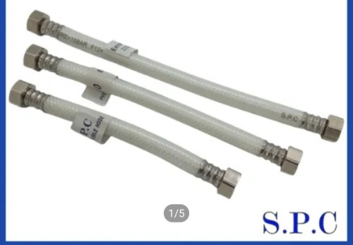

mushigen
4,954 posts
Joined: Jul 2010
QUOTE(plouffle0789 @ May 28 2024, 11:38 PM)
Instant water heaters only have one cold water inlet pipe. You regulate the water temperature by toggling the set temperature switch/knob.
The isolation valve is located at the inlet of the heater. The outlet of heater is not supposed to have any valve to avoid over pressuring the heater and cause internal leakage.
Also, you're not supposed to use steel hose or pipe to connect to the heater to reduce risk of electrocution.
mushigen
post May 28 2024, 11:48 PM
4,954 posts
Joined: Jul 2010
The heating coils are not supposed to be subjected to any pressure by having the water stop valve at the inlet and no valve at the outlet.
I highly suspect TS' connected his instant heater the way storage heaters are connected. The difference between them is storage heaters have pressure relief valve and instant heaters don't (or I've yet to see any). So any overpressure in instant heaters will cause internal leakage as in TS' case.

QUOTE(mushigen @ May 28 2024, 11:48 PM)
I think Panasonic brand water heaters have the valve you mentioned.
But kesian Joven brand do not have the valve.
Does this valve reduce the pressure from the main water supply pipe of the water company?
Some water companies supply water to our house pipes at too high a pressure.
This post has been edited by plouffle0789: May 28 2024, 11:56 PM

QUOTE(ozak @ May 28 2024, 11:52 PM)
There is no different in what model.
Tell me more detail where is the exact the leak.
I probably can understand why it leak.

ozak
post May 29 2024, 12:04 AM
10k Club
17,021 posts
Joined: Jan 2005
QUOTE(plouffle0789 @ May 28 2024, 11:57 PM)
where is the pipe joint leak? It is from the hot water outlet joint?
Exactly at where?

My house in Malaysia also uses a Panasonic water heater, and we've had it for 9 years already.
However, I need to close the volume switch every time after pressing the big button on the Panasonic water heater.
If I don't do this, water keeps coming out even after pressing the big button.
The same thing happens when I want to take a bath.
If I don't open the water volume switch and only press the big button of panasonic water heater, no water will supply to the water heater, and it will make a noisy sound due to high pressure.
Why like that?
This Joven water heater is at singapore house.
TSplouffle0789
post May 29 2024, 12:10 AM
1,836 posts
Joined: May 2010
QUOTE(ozak @ May 29 2024, 12:04 AM)
Exactly at where?
Actually is water tank leak..
Internal leak
I saw before last time...
This post has been edited by plouffle0789: May 29 2024, 12:10 AM

The part you circled should be the flow switch which switches on the power to the heater and cuts off the power when there's no water flow.
The high supply water pressure should not be an issue because you can regulate the flow (hence the pressure) by using the inlet valve.
As I said, if you installed a stop valve at the outlet (hot water side), you risk over pressuring the heater coil.

QUOTE(ceo684 @ May 29 2024, 12:17 AM)
The piping nut is using compression fitting. By right it’s supposed to use hand tight only not twist until the tank break. If using flexihose the procedure is turn using hand and add a 1/4 turn with spinner and stop. It is sealed by the washer French kiss NOT by the screw thread. The plastic tank is not supposed to use compression fitting with the olive ring inside. It will break.
The below blue circle?

Water heater with a big water tank outside...
Please look at all the photos I posted again.

see the photo, oredi warning there... chrome pipe or faucet should not be used
electric, water, metal should not mix, and the recipe is complete here

QUOTE(alexei @ May 29 2024, 10:51 AM)
1st picture and this, kennot imagine how TS didn't see sparks flying or tak masuk lagi berita for electrocution.

QUOTE(fu'house @ May 29 2024, 11:19 AM)
The technician is not water heater expert
Houseowner want to save money

QUOTE(alexei @ May 29 2024, 10:50 AM)
I think average users don't want to know these.... reality is a bit sad
just lucky the ELCB is tripped, else later found out "elcb is bypassed because always trip since the plumbing technician say is ok"
The technician last time told me his main job is to install lighting, not to work on water heaters. Maybe he also doesn't understand how water heaters work..
So the homeowner wants to save money...
Last time he told me not to use the maximum water volume; he said this would spoil the water heater.
But the water is still cold, and even after 5 minutes, no hot water comes out.
So I use maximum water volume.
This will cause leaking?
Do you think what he told me is true?
This post has been edited by plouffle0789: May 29 2024, 12:38 PM

QUOTE(alexei @ May 29 2024, 12:53 PM)
wait... the heater is connected to the hot water supply of the whole unit?
For my guess the red and blue is exiting piping, homeowners probably remove the existing boiler and install this new instant heater
If you see the diagram probably cold via instant heater and exit old hot piping shower head
ts should save all the hassle only use the incoming blue piping and only use the stock shower head+flexible hose given by the instant water heater
Since the exiting piping is conceal under the wall if the wall is cold and is long also the wall also good at absorb heat i guess by the time reaching at the end the water ia already cold

Yes. Or you could have turned off BOTH of these in your photo here when not in use

QUOTE(Momo33 @ May 29 2024, 01:45 PM)
so where is the water leak from .
from pix  i guess the steel pipe  /black connect  at the outlet ??
maybe need more tape at the joint/
Internal water tank inside water heater is burst.

If ts don't want overdone suggest using this simple method, the setup your have right now are over configuration
Try not to using elbow around inlet can create air lock
On red circle
Use male to male for wall cold water
Then flexible hose all the way to instant water heater inlet how long you need i tak tahu sendiri measure but this nylon hose can sustain 3 to 4 bar without issues make sure you keep the existing oring when tighten this flexible hose if not given remember to bought 4 pcs in case water heater exit stock flexible hose dah hilang
Don't forgot all the male balut white tape in clockwise direction if you do it counter clockwise can tear up the White tap when tighten it
This is more cost effective and budget and very straightforward
If you know what you doing

panasonic  usually  use a  metal can heater
So, the Joven brand uses a plastic water tank that cannot withstand the inlet valve being open (high pressure) all the time?
This post has been edited by plouffle0789: May 29 2024, 02:32 PM
Momo33
post May 29 2024, 02:36 PM
1,448 posts
Joined: Oct 2019
QUOTE(plouffle0789 @ May 29 2024, 03:31 PM)
So this Joven brand use plastic water tank and cannot tahan inlet valve not closed(high pressure) all the time?
yes.. i think so .
the pana can is 1 complete metal can unit ..
the joven can is a metal top fused to a plastic can ... that seal maybe not strong enough.

Piping problem, use flex hose at inlet and outlet at water heater.
The metal length incorrect length causing leak.
Don't cheap stake, go get a unit with ELCB like panasonic

TS. if ur renting u should report this to hdb. that low grade joven instant heater is not meant to be connected directly from water inlet and to hot water outlet. it cannot take the pressure. this piping is only for storage heaters. that hot water outlet is to supply to all the bathroom in the house. no instant heater has the capacity to do that.
if this is your house..... good luck.
to others. steel exposed piping is usually used in hdb for connecting all the water inlet to your taps, storage heaters and shower and the main risk is the water storage heater which is properly grounded.
you can use instant heater but the inlet and outlet to instant heater is usually grey pvc pipes.

is there a misunderstanding on the metal hose ?
nowadays from the metal hose provided by the manufacturer the connector are plastic between the heater to the hose, so it should be fine

Have you check your house water pressure? Nowsaday all instant water heater use plastic container to hold the water to boil the water. Over the time, the container will crack or degrade, which I experienced on two diff brand of water heater - joven and alpha - after over 7years of using it.
Move over, your house water is quite rusty, based on the picture in your post, caused the rubber seals harden?
Alternative, go for tank based water heater - joven not bad. Using it now.

Assuming yr wiring is done correctly, the water leakage is obviously due to improper connection or rubber seal worn or none. Every shower manufacturer states that shower hoses (inlet & outlet) must user rubber/pvc type and NEVER use those that conduct electricity. You are obviously a novice DIYer. For yr own safety sake, get an electrician and plumber for thr job

Obviously some installation problem with the water leaking out. Also, the warning label already said not to use chrome or metallic pipes and look what's connected to it?

https://www.panasonic.com/my/consumer/home-...h-3ndp1msr.html
I plan to install this new water heater at my house.
On red circle

I am not sure which is the best. My friend say Panasonic.
But my short research tells me that there are no concept of energy saving.... Didn't see any tnb 5 stars in any of the water pumps.
So I ended up buying the rubine Cetus... purely cuz it comes with rain shower and is aesthetically pleasing in my point of view.

panasonic have jet pump built in

niceit198
post Dec 7 2024, 08:55 PM
33 posts
Joined: Nov 2017
As u say your water inlet leaking also , your water heater features cause ?? Assume not enough water go in boiling then overheat ? Check degree?
Anti-scalding Protection
Manual reset Thermal Cut-off
High Pressure Protection
Power Indicator:
Power I & Il Indicators
Overheat Indicator
Features
Auto Power I cut-off at 60°C and reset at 35°C
Complete power cut-off at 90°C and requires manual reset
