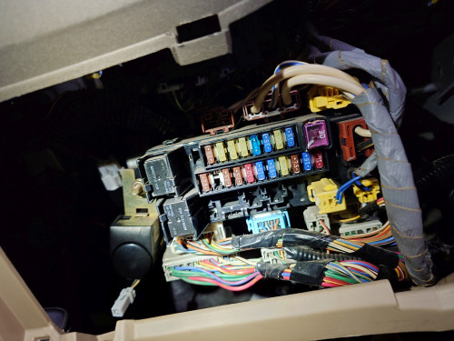

I disassembled the lower dashboard and see only the fuse box and a mass of wires... but no sign of the control box. Even tracing the code button wires didn't help because it joins the other chassis wiring confused.gif :-
