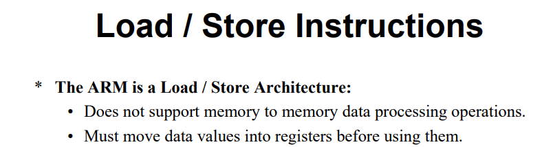

Unlike x86, ARM does not support memory to memory data processing, which in turn use a load / store architecture (LDR for load, STR for store).

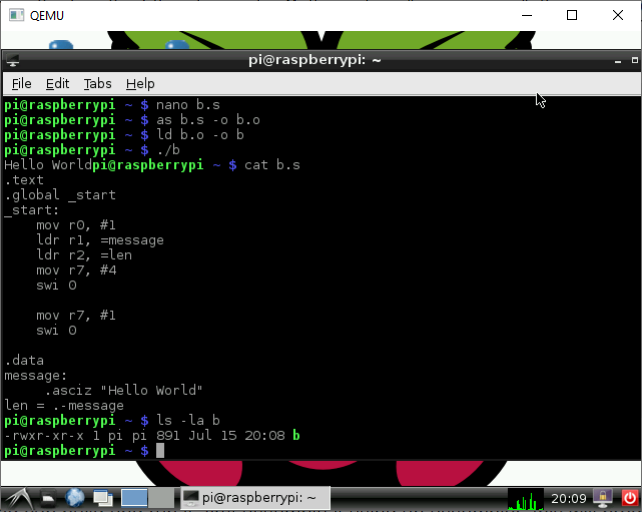

To compile, use GNU Assembler (as) and linker (ld). It is as simple as:
CODE
as b.s -o b.o
ld b.o -o b
Then just run with "./b". Upon checking with "file b", it is a 32-bit Linux ELF ARM. Check with "readelf -a b" will show file headers and symbol table.
To make the ELF executable smaller, can use "ld b.o -s -o b" to strip off the symbol table.
