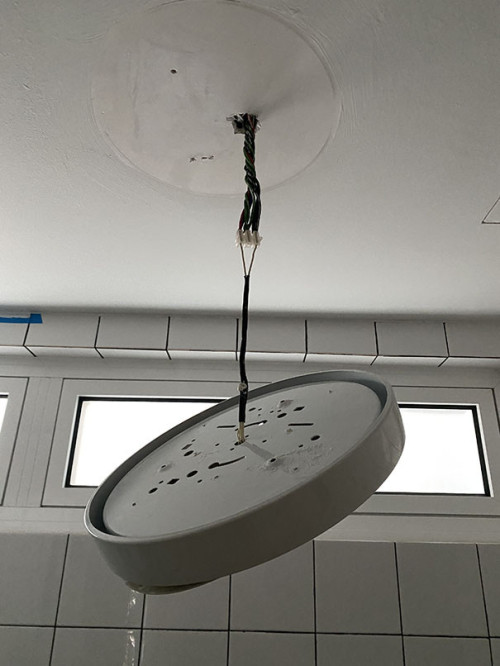

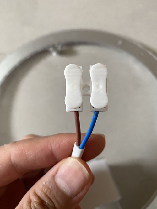

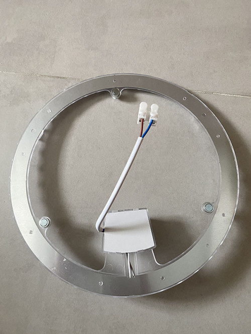

Hey guys, am trying to replace this ceiling light with one of these new magnetic LED modules. The new module has this clip thing where I can connect the wires but am not sure which colour wire to match which? confused.gif

blue go to black, brown go to red
please cut off the main supply during connection

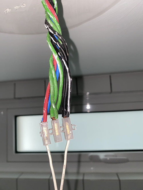

Ok, if you see from the pic, the red one also has blue wire together with it, do I still keep them together when connecting?

Hey... just take out the white one and then follow the first reply. There's 2 screw on each column. Only loosen the one nearest to the white.
Don't mess with other wiring because they are connected to other lights.
