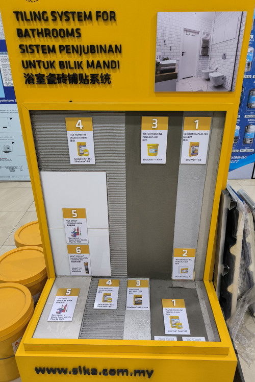

I just happened to stop by at a hardware shop, and saw this display for Sika products
