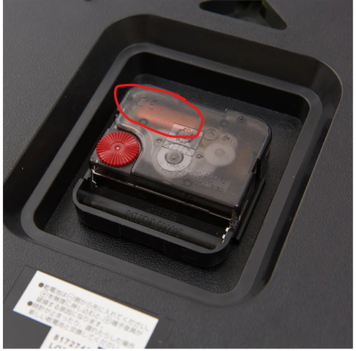

 Why this clock cannot use rechargeable battery?
TSSkylinestar
post Nov 21 2023, 07:25 PM, updated 3y ago
Mega Duck
10,477 posts
From: Sarawak
https://www.nitori.my/collections/wall-tabl...lock-shao-sw-gr
Nitori WALL CLOCK SHAO-SW-GR
[Battery used]
AA x 1 (sold separately)
*Rechargeable batteries cannot be used.

QUOTE(brkli @ Nov 22 2023, 12:08 AM)
then means this clock is sampah.. for a 1.5V battery can use until 1.2V only.. than like around 50% of an alkaline battery capacity. meaning when the clock stop running, u put the battery into say a remote, it is likely still usable.
when do u throw away battery? when it can't power up a remote? when it can't power a clock? what device can run with the weakest battery?

Just use phone.
Virlution
post Nov 22 2023, 07:58 AM
483 posts
Joined: Jan 2010
for clock, use cheap carbon zinc battery, dont even need alkaline..
Rechargable at full charge only dish out 13.4v and not close to 1.5v, so clock might run slower. After a while with it will only put out like 1.2v then you will lose few minutes every month.
Also rechargable not suitable for slow drain battery, more for fast drain like Alkaline replacement.

theres quite alot of engineering that goes into clocks or timekeeping device
changes in the voltage can somehow make the accuracy deviate AFAIK, like for example if you set in clock 1pm to tie with official time, then due to issues with the clock when its 2pm your clock still shows 1.55pm or something like that
thats one of the reason why some watches are so darn expensive, cause their device have to also guarantee super precise timekeeping
marvinben
post Nov 22 2023, 11:38 AM
249 posts
Joined: Mar 2010
The quartz crystal is responsible for time keeping and doesn't really care about 1.2V from rechargeables. But the part I circled in red does. It's a puller solenoid responsible for the clock movement and it need the 1.5V nominal from alkaline/zinc carbon battery.
You still can use rechargeable battery, just charge them more often.
