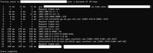

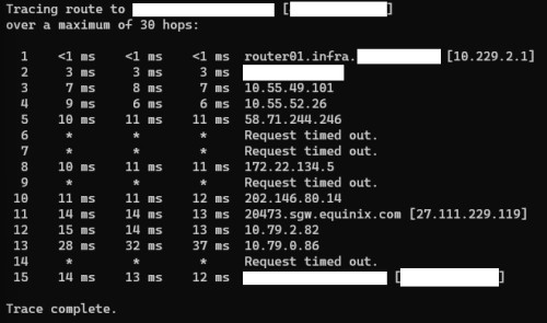

Somehow pings to my VPS in SG (Vultr) is significantly worse over ipv6 compared to ipv4. Anyone know whats up with that?
From 13ms to 206ms. I feel like something is off with their routing. Like, is it being routed out to US or something before being bounced back to SG?
IPv6
IPv4

Somehow it's routing though NTT Japan, NTT America, "Tinet GmbH", before going back to vultr in singapore. It's really going on a trip around the world....
Tracing route to 2001:19f0:4400:4001:5400:ff:fe32:b7e5 over a maximum of 30 hops
1 <1 ms <1 ms <1 ms <REDACTED>
2 * * 7 ms 2001:d08:b1:2::2
3 * * * Request timed out.
4 14 ms 14 ms 12 ms 2001:d08:b1:22::6
5 6 ms 7 ms 7 ms 2001:218:e000:5000::3f9
6 27 ms 19 ms 7 ms ae-5.r23.kslrml02.my.bb.gin.ntt.net [2001:218:0:2000::1b2] <------------- NTT Japan
7 * * * Request timed out.
8 90 ms * 93 ms ae-13.r33.tokyjp05.jp.bb.gin.ntt.net [2001:218:0:2000::c6]
9 * 177 ms * ae-4.r25.lsanca07.us.bb.gin.ntt.net [2001:218:0:2000::62]
10 174 ms 186 ms 181 ms 2001:418:0:2::212 <---------------------------------------------------------- NTT America
11 176 ms 178 ms 181 ms 2001:418:0:4000::9e
12 319 ms 320 ms 328 ms 2001:668:0:2:ffff:0:8d88:6e9e <--------------------------------------------- Tinet GmbH
13 320 ms 327 ms 320 ms 2001:668:0:3:ffff:3:0:46
14 218 ms 217 ms 217 ms ethernetet-0-0-35-sr1.sgp1.constant.com [2001:19f0:fc00::a4f:1a1] <--- Vultr
15 320 ms 320 ms 321 ms ethernetswp55-ds1-u2-1155-a.sgp1.constant.com [2001:19f0:fc00::a4f:136]
16 * * * Request timed out.
17 320 ms 319 ms 320 ms 2001:19f0:4400:4001:5400:ff:fe32:b7e5
Trace complete.

Only Maxis can fix this problem. It is because they didn't peer with Equinix SG on IPv6.
Here is how to verify BGP routing...
Refer to Maxis IPv4 peer:
https://bgp.he.net/AS9534#_peers
You can see from your IPv4 traceroute it go from Maxis directly to Equinix SG.
From https://bgp.he.net/AS9534#_peers6 you can see Equinix SG is not peered for IPv6.
Alternatively, you can see the IPv6 don't have "X" under Peer v4.
You then need to check Graph v6: https://bgp.he.net/AS9534#_graph6
Line in BOLD means they are upstream provider.
Maxis has 3 upstream provider: Telecom Italia, NTT, TATA.
So Maxis just dump the packet to one of their upstream, which is NTT.
NTT route the packet to AS3267, which is GTT Communications.
It is not TiNet.
GTT has a public Looking Glass:
https://www.as3257.net/lg/
2001:19f0:fc00::a4f:252 is located in London, so you can choose any LON router, and enter your destination address:
You can watch your packet traverse their MPLS network.
You can also do the reverse and start from https://bgp.he.net/AS20473#_peers6
You might be wondering if both the source and destination share a common peer, which is NTT, why do the packet need to traverse GTT?
Fortunately, NTT also has a Looking Glass:
https://www.gin.ntt.net/looking-glass-landing/
If you select BGP and see the prefix announcement, the two network didn't actually connect directly
This post has been edited by kwss: Nov 27 2023, 06:08 PM
